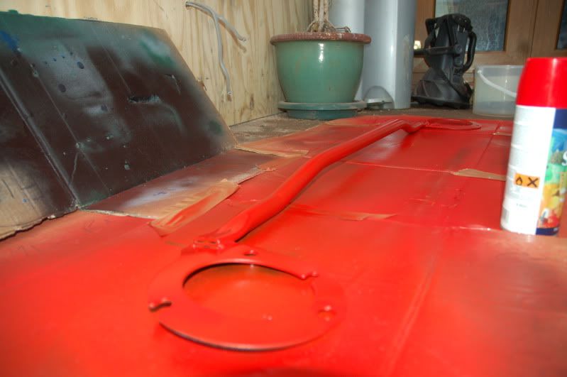

Strut brace finally sprayed up as BMW bright red wasn't actually that bright and had to get some more spray

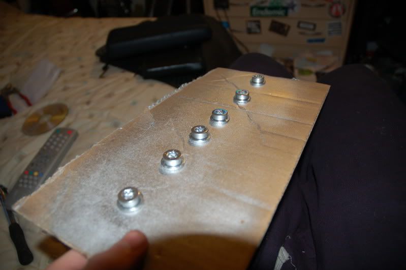

Sprayed the bolts silver (as a layer to protect from rust)

a painted strut brace looks good, i want to get mine painted china blue not as nice as your bmw red, liking the idea of spraying the bolts.

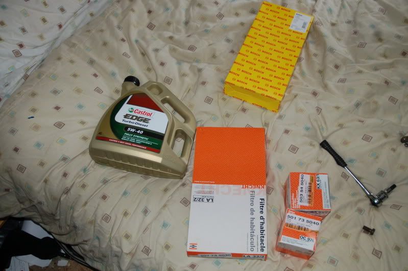

DON'T USE THAT OIL!
It will leak out of every orifice on the engine! Get some 10w40 SEMISYNTHETIC! even 15w40 Miniral oil would be better than that stuff!

i was thinking that bailes,
isnt that fully synthetic ? 5w 40 ?
peugeot told me not to use fully in my 1.9 xud

if you use fully synthetic from day 1 then it's not an issue.
These engines were developed in the 70's when only miniral oil was really avalible. Most taxi drivers run 15w40 mineral oil in these engines cause it's cheap and gets changed very regularly. Mineral oil is fine.
But the best oil for these engines is 10w40 Semi Synthetic.
If you start putting Fully Synthetic oil in an engine thats only ever used Semi Synthetic or Miniral oil it will fine it's way past the seals.

The petrols are much more modern engines so I can't really see an issue.highlander wrote:I just put a litre of Castrol Edge 5w40 fully-synthetic into the Coupe a week ago... I have no idea what oil its been run on for the last (nearly) 9 years
I'm going from Fully Synth to Semi Synth in the Focus cause it's cheaper

Flip well thats annoying about the oil, will try to exchange it next time i'm near the shop. Thanks for the warning though

Sprayed them to give them a protective layer.
Also the BMW red ran out early and wasnt that red at all. I went B&Q and got a gloss spray 400ml can for the same price, much better quality.

The bolts i got were pretty rusty so left them in vinegar for a week and they came up near rust free.FarmerPug wrote:a painted strut brace looks good, i want to get mine painted china blue not as nice as your bmw red, liking the idea of spraying the bolts.

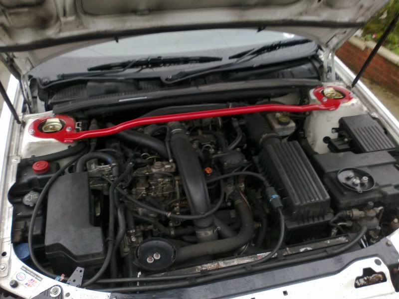

Its finally on, a small bit of rubbing but nothing major. I have noticed the handling is much tighter but have yet to put it through its paces as was driving about in heavy traffic

does the bonnet close properly with the strut brace ?
