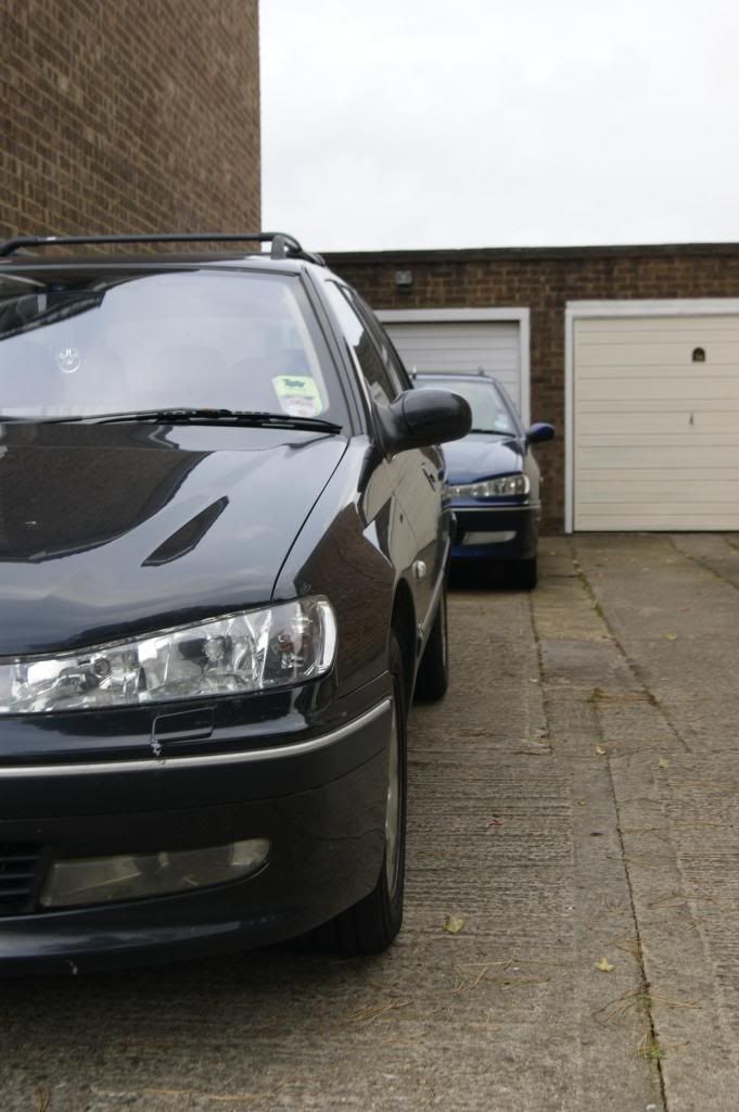

I am collecting Pugs on my drive :lol:
As you can see HE is absolutely filthy. Air vents are in a shocking state.
One thing for certain, I did not expect lift reverse :lol: :shock:

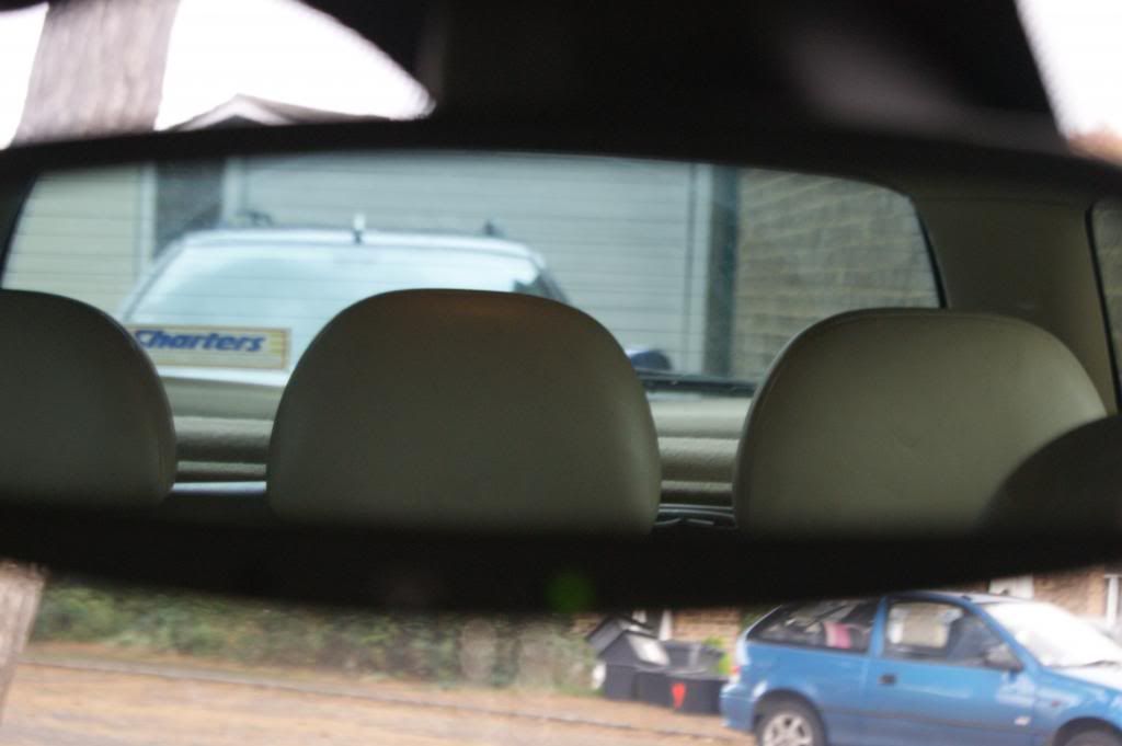

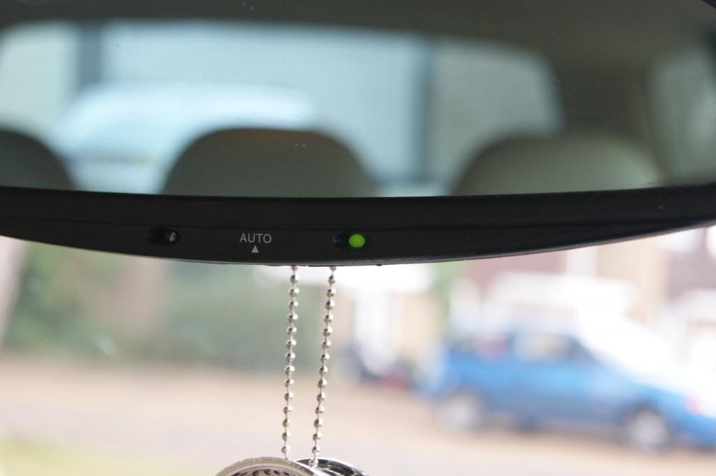

What is automatic about the mirror? (Great view of Miss Pug by the way)
I somehow turned on automatic lights :shock: but haven't found the follow me home feature... :lol:

auto-dip mirror is good, 8)

No idea where the light washer switch is - does it use the same feed for the windscreens washer?
Need some work doing... will go out when it's dark to test the auto dip mirror :lol:

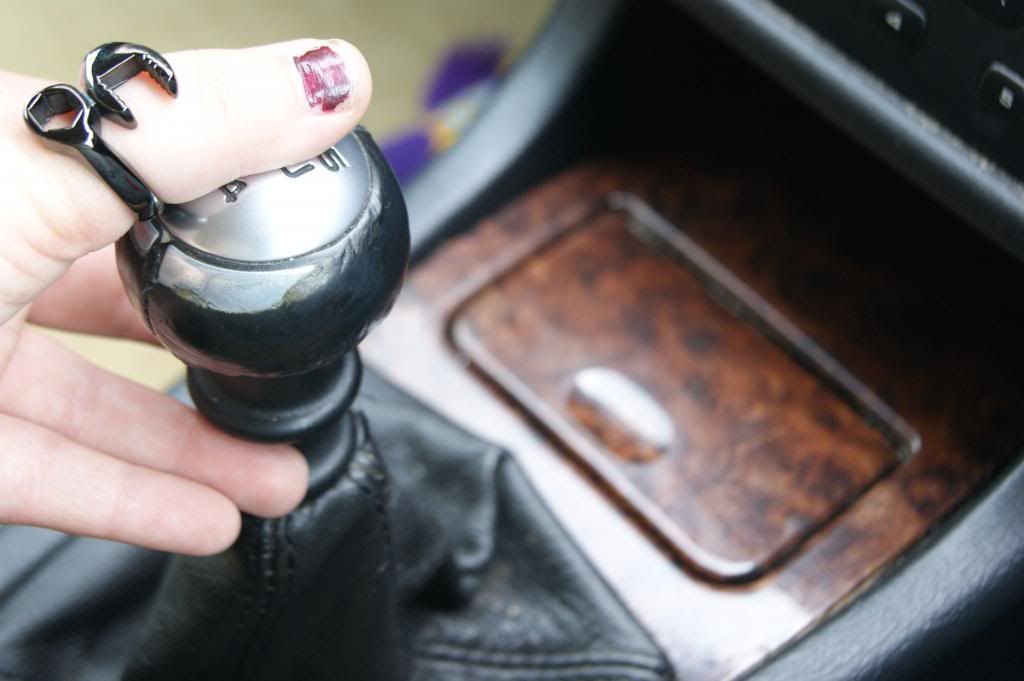

You could do with refurbishing your knob....
I knew it'd be only a matter of time before some bright spark mentioned my knob :lol:
Thanks... I will have to look :D

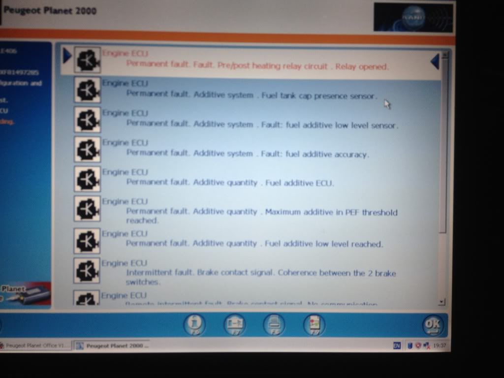

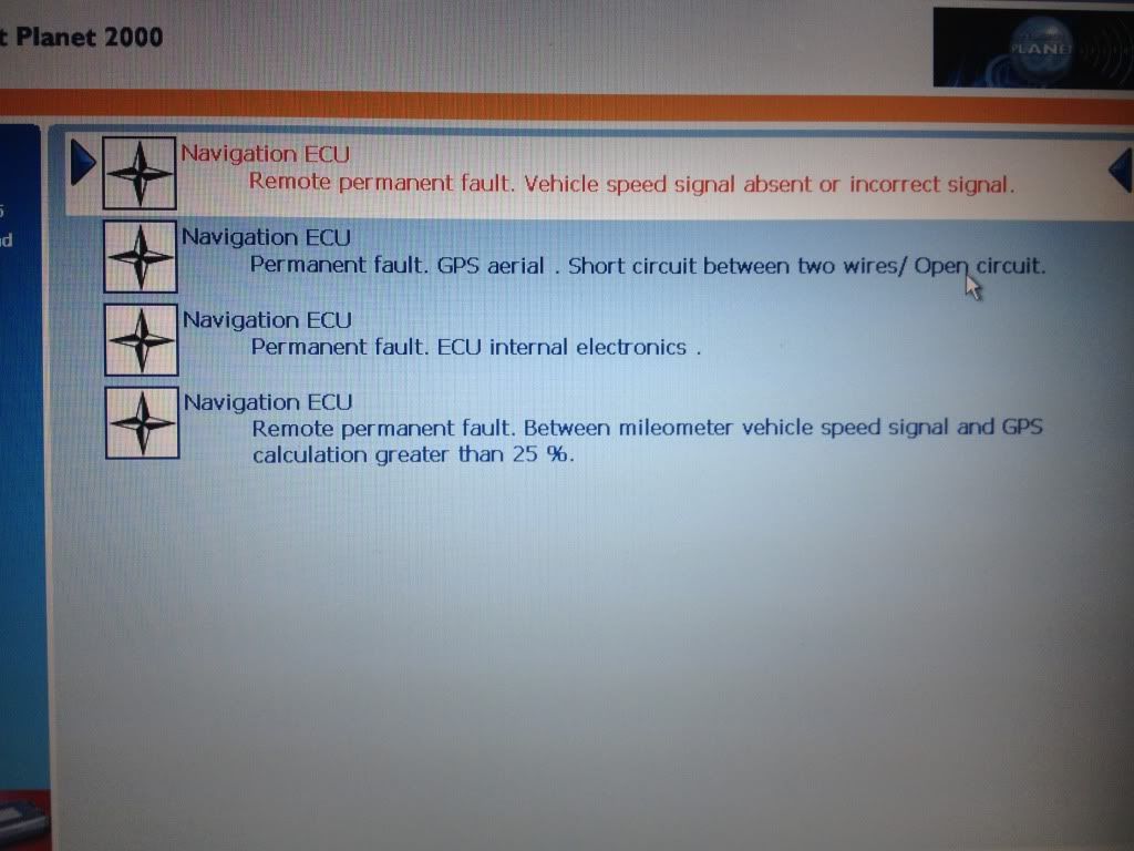

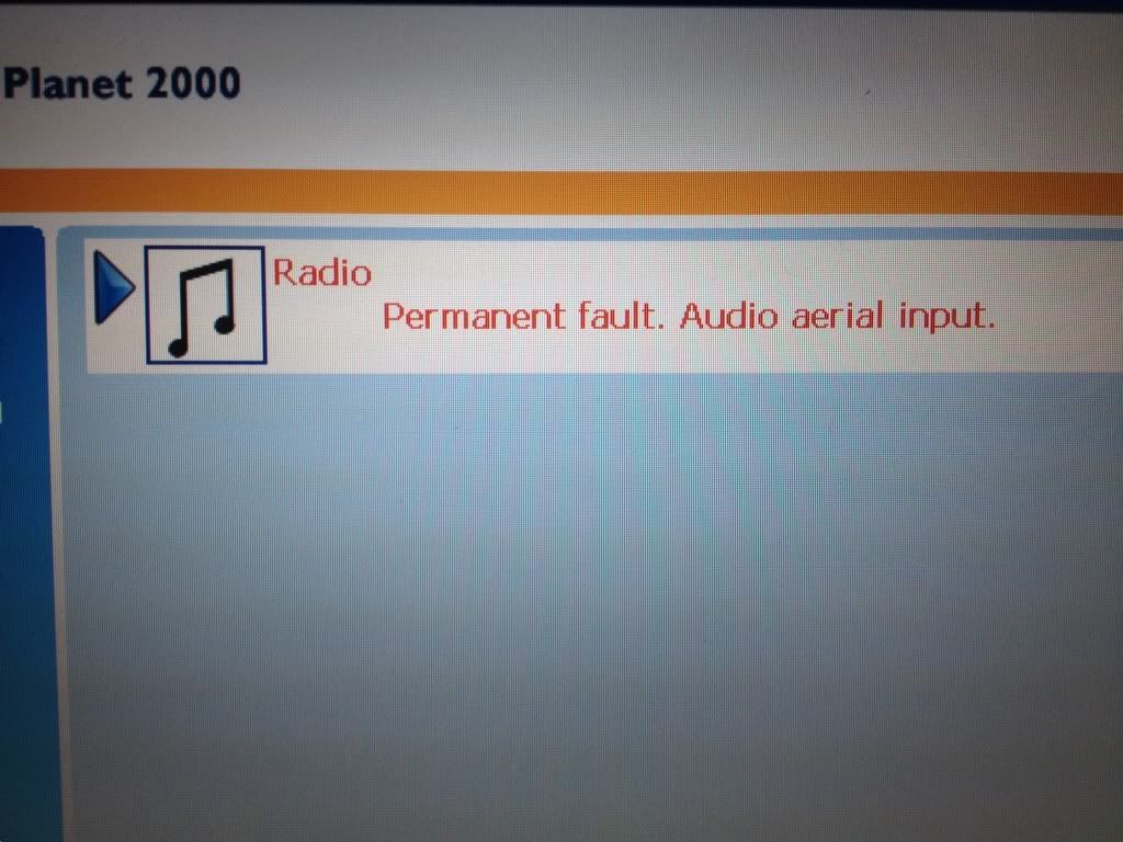

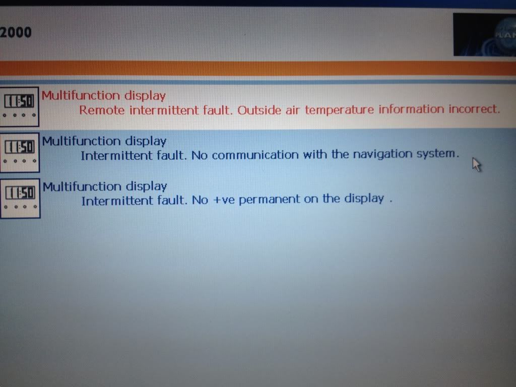

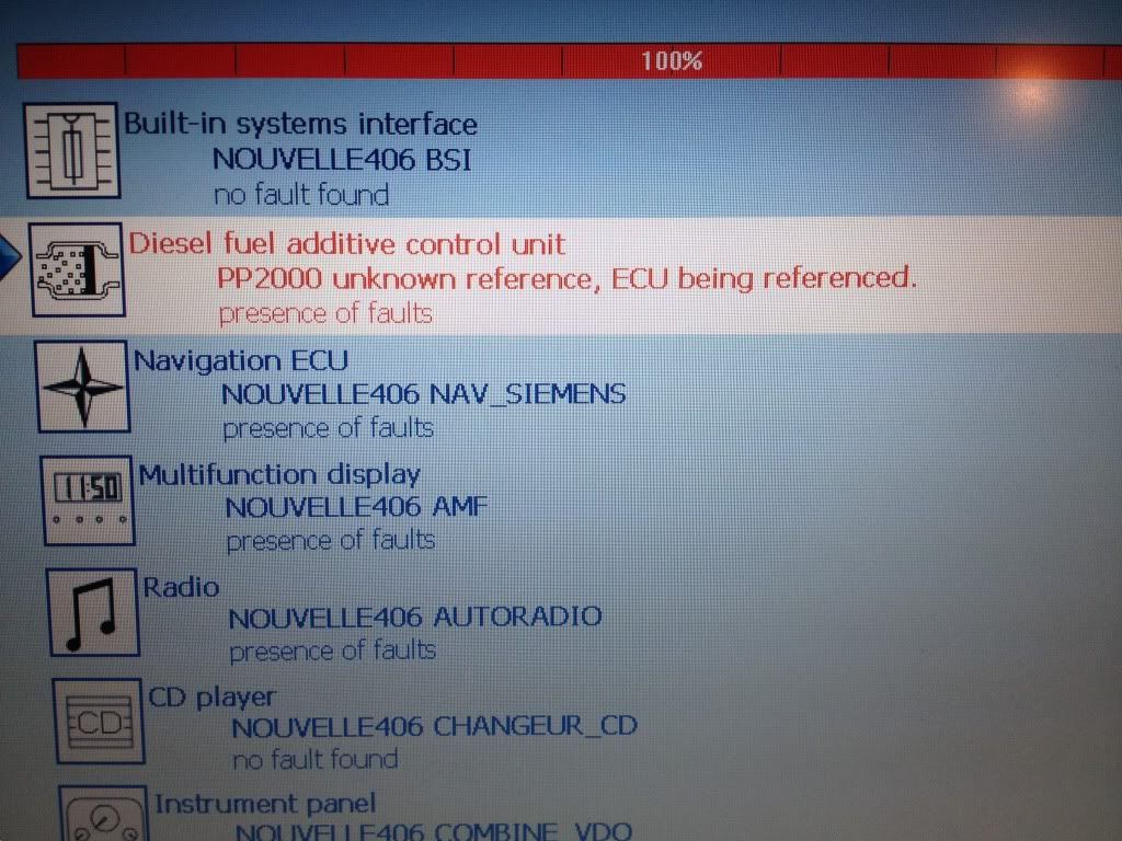

Plugging into PP was an eye opener :shock:
Many a faults flagged up, a few to do with the engine ECU, a lot to do with the additive and DPF

I have most of those on mine too...
Ignore the pre-heat one as I think most Hdi's have that fault.....
The Navigation fault could be because you weren't moving.....?
Outside air temp is the same as mine but the temperature displayed is correct..??!!
All the other additive faults will be sorted with de-fap so that's cool.
Remember, just take one thing at a time and it will be okay.
