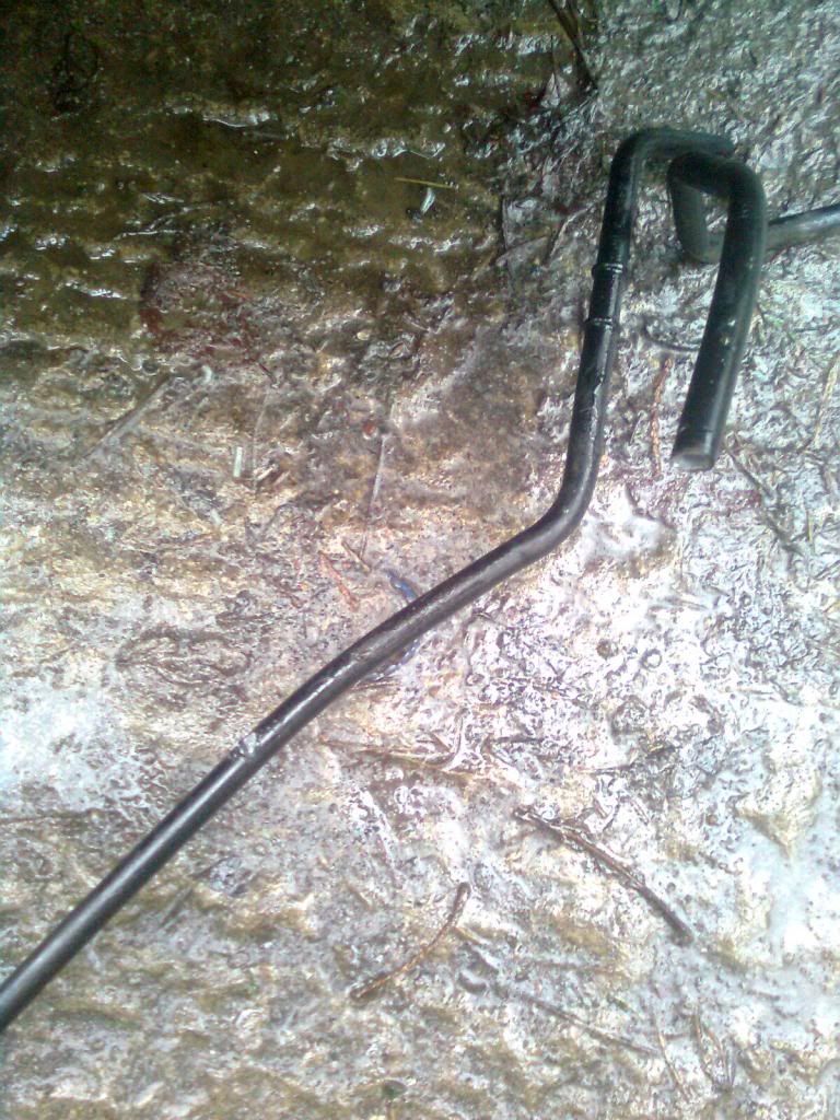

In recent days my D8 has developed a leak too!
I think it's number 9, and looks a right pig to change :cry:

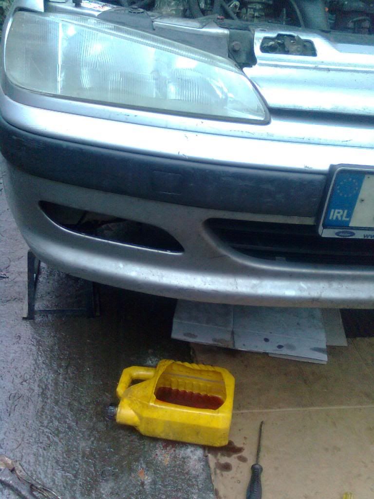

What a miserable job that was!!! :evil:
The pipe was somehow cut....
I found access was greatly improved when the foglight (or cover in my case) was removed
