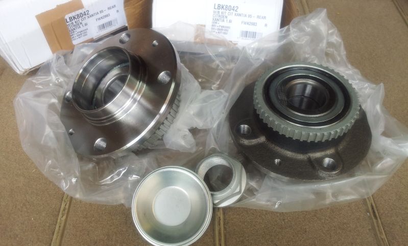

DaiRees wrote:Nope, original bearings.
Kinda makes sense to do them dont it.... It's not my money i'm spending here though is it. :lol:
Re: Rear Brake Back Plates.... again!
Right, bearings ordered, £36 each from my local motor factor.
Total so far... £258.86. :cry:
Anyone fancy taking a guess at what the labour's gonna cost?

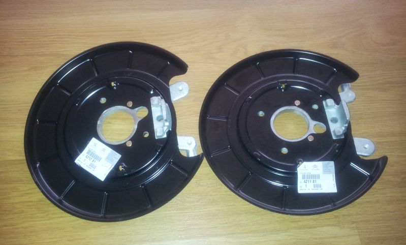

DaiRees wrote:Oooh, new bits!
I'va also cracked under the strain and ordered new Mintex discs, pads and handbrake shoes.... Damn this job is getting expensive.... :cry: :cry: :cry:
I can see why these are expensive Dai, they seem to have the caliper mounting built into the backplate assembly.
No wonder you can't buy aftermarket ones.
Good idea doing the discs/pads/shoes at the same time :D Expensive, but worth it in the long run if you intend keeping the car a while.

jasper5 wrote:I can see why these are expensive Dai, they seem to have the caliper mounting built into the backplate assembly.
I was a bit surprised to see those fairly heafty castings attached to the back of the plates too mate, as you say, no wonder you can't get after market ones.
Point of interest here: the bloke in the dealer had the part number up for back plates for models with rear drums first, and he reckons they're discontinued and can no-longer be sourced (scared me for a moment 'till we realised he had the wrong ones!! :roll: ). Dunno whether that means that they don't rot like the disc version, or that if they do rot you have to scrap the car?? :? :roll:
Anyway, more new bits....

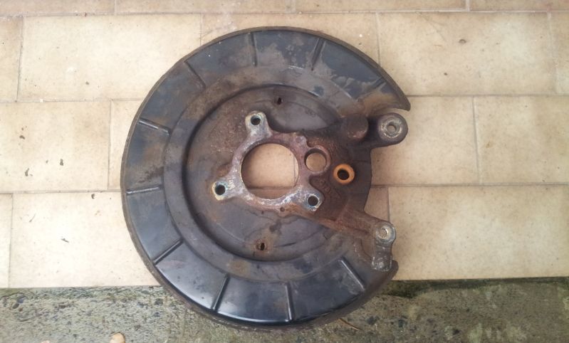

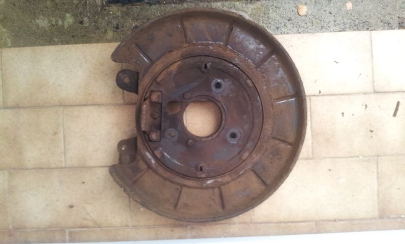

Right so the old bus has been in the garage all day, and it's still there :(
Firstly she needed new hand brake cables, the old ones were a bit knackered but more importantly they just weren't going to come out of the back plates intact and in any kind of re-usable condition :roll: .
Then, when the job was nearly finished and the mechanic rang again to inform me that I have a stickng caliper :cry: . Nipped up for a look and it is indeed knackered, explaining both the unevenly worn and scored disc, the excessive brake dust on that wheel recently and the small yet noticably drop in economy. Actually I'm pretty certain that this has only happened since the back plate failed, but I can't see how that alone would cause the caliper to sieze :?
So a service replacement caliper is on order which will push the parts spend over the £400 mark :cry: :cry: , with labour costs still to come tomorrow :cry: :cry:
Anyhow, I'm glad I'm replacing the whole lot in matching pairs but my assumption that because the one back plate was rotten the other one must be in a similar state turned out to be bolox. While anything left of the offside plate was lost in the removal process leaving just the casting, the nearside one is in remarkably good nick. There's a bit of surface rust on the inside but a wire brushing and a coat of hamerite would see it fit for several more years of service... So if anyone finds themselves in need of one, give me a shout!
