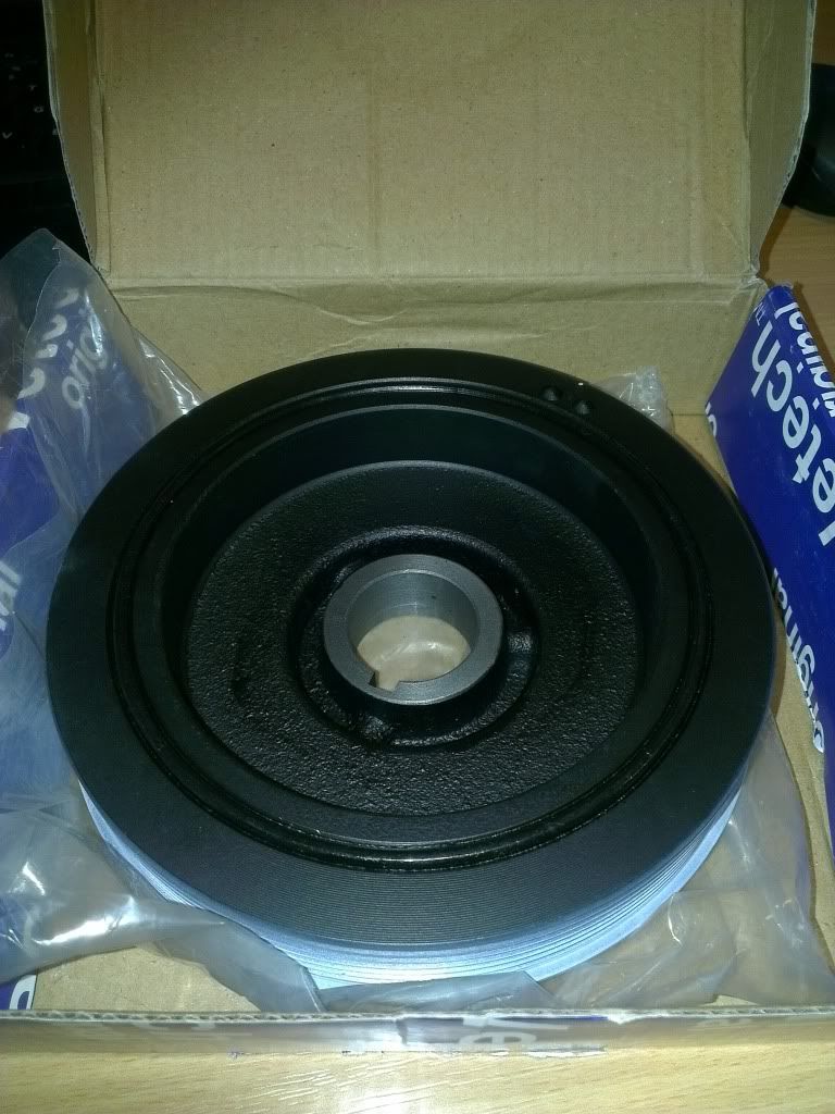

It's here!
If this doesn't work, the car is going in the bin.

Re: Steering column rattle
It didn't work
The problem is exactly the same - I can see the pulley wobbling a bit, which causes the tensioner to go crazy. I am completely out of ideas now.
BTW, do I need to threadlock the bolt? I didn't have any on my so I just tightened it up as tight as I could. Undid the bolt using jasper's method - works brilliantly!
