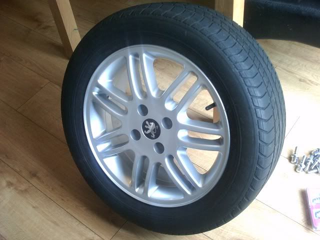

it took me a while to find a set of 16 inch 406 wheels .
thanks to waue i ended up with a rare set of 16 inch Vulcan 406 alloys that were brand new and still look it today
he posted the link from ebay on forum and i had to have them as soon as i saw them
had to travel 550 miles round trip mind. to get them
heres a pic of the vulcan wheel . not many of these around i beleive they was a optional extra which not many paid for
you do see these on a lot of 206s but as waue says they dont fit and i think the ones on a 206 are 14 inch . the 16 inch like mine for a 406 are very hard to come across
