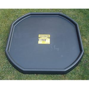

Just a thought (yeah, I know, but it's bluddy snowing again :( )

steve_earwig wrote:Just a thought (yeah, I know, but it's bluddy snowing again :( )
Great idea, but you're relying on Mrs. B to park the car over it without hitting it, breaking it, etc and then of course, actually get the car directly over the pan.......
......'Fraid it's jet wash and elbow grease for me!!!
