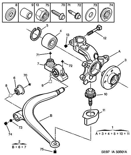

I have a list of part numbers and wanted to ask you guy's if i'm correct in which ones are compatible.
Clutch: 2050.Y2 or possibly 2052.J1
Front break discs: 4246T6
Drive shaft bearing: 324703
Rear anti-roll bar suspension bush: 517243 / 5172.43
Front Wishbone Rear Bush: 352361 (this does say it ranges between 95-04 but want to be sure)

One other question i would like to ask is, how/were can i identify the exact model for my vehicle?
I've looked on the DAM label on the drivers door but it has a 10 digit code which has completely threw me.
I was also looking for the ID tag for the engine to see which type it is but i can't see that anywhere.
Can someone guide me on where to look for these and also help with my original post please?

Hi,
to get the correct info on parts you need,you wouid be best to run your vin number through service box,
perhaps someone wouid kindly do that for you if you asked,
ipresume your car is D8 Mark 1
the Treg you mention in the Breakers yard may be an Early stage Mk2 -d9 you wouid be best checking its the same as yours before taking parts from it,

If you don't want to put your vin publicly on the forum, then pm me your VIN and i'll run it through Service Box, put up your vehicle characteristics and confirm part numbers
Also if you can get the VIN off the T reg in the scrapper, I can confirm if the shafts are the same

Yes, your car is what we refer to as the D8 - as you correctly say, pre facelift
** that part number relates to number 7 on this schematic - if that's the one your after then also correct
Clutch: 2050.Y2 or possibly 2052.J1 clutch plate is 2055 Z4 - clutch kit is 2050 S9 - exch clutch kit is 2051 44(replaced by 2051 T2)
Front break discs: 4246T6 4246 R7 ( replaced by 4249 J1 )
Drive shaft bearing: 324703 correct
Rear anti-roll bar suspension bush: 517243 / 5172.43 correct
Front Wishbone Rear Bush: 352361 **

Wow.
Thanks Plod.
I wasn't expecting that.
Yes, number 7 in the diagram is the part I was referring to.
Is that part pretty much universal across the 406 range?
Thanks again mate.

Hi Plod,
On the schematic you have provided, could you tell me the part name and no. for item number 10.
I'm having a look around and noticed it is very much like a track rod end but seems, based on what i've seen, to screw in.
Also, what are the chances of the ABS reluctor rings being damaged, or just needing to be replaced, as i have seen two types that are both for the 29 teeth variant.

10 is 3640 71 Ball Joint Susp
