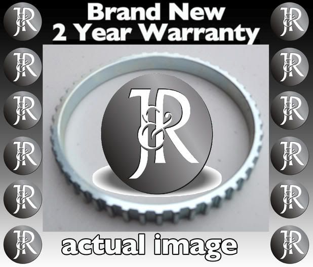

I'd check your reluctor rings, if one of those was slightly busted it could cause similiar symptoms to what you're describing. But no vibration through the steering wheel though, mainly through the brake pedal. Should feel like a 'clunk clunk clunk ' feedback from the wheels.

it is a clunk when breaking hard,as u say not through steering just pedal,what r reluctor rings m8 ????????

The relucter ring is fitted to the CV joint it's a ring of "teeth" that pass over the ABS sensor as the wheel turns which detects the speed of the wheels/driveshafts to help the ABS system to work, did your new CV joint have this?

The relucter/ABS ring is on the drive shaft just behind the disc , it is a ring
that has 48 teeth on it that activates the ABS sensor . They are prone to rusting
then splitting sending false readings to the ABS .

But you have three other reluctor rings. Any one of these could be the culprit. Sometimes when they split the damage can be hard to spot as the crack is only as wide as a gee hair. Other times it can be something as simple as a missing tooth or even lodged dirt.dieselink wrote:thanks guys but just put new cv joint on yesterday

putting it in for mot next week,so i need to check the other 3 rings for any defaults then ???????? i will also check the sensors r clean and check pads r seated properly,thanks guys

Yes unfortunately. A time consuming job but worth it if it turns out that it is the root of the problem as reluctor rings are cheap (I think) and sensors are only 20 quid on amazondieselink wrote:putting it in for mot next week,so i need to check the other 3 rings for any defaults then ???????? i will also check the sensors r clean and check pads r seated properly,thanks guys

dose anybody know if u can change rings on rears or r they part of the hub ????????,i know the fronts r part of the cv joint,well looked that way when i changed it.pissing down today,so wont be doing today.
