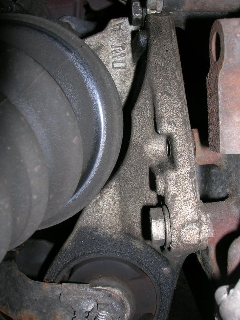

Thanks Jasper. It looks a little different from the pictures I posted. There are no notches near the holes and it just generally seems like a different bracket.
Can you line them all up and take a picture from the top?

Yeah, it's definitely different. The bolt holes near the driveshaft hole are in different places from mine.
I am going to take the wheel off and see if I can get a closer look at mine - even the photos I posted seems different from the close up pictures I've taken!

OK! It's definitely like the one in 3 pictures I posted earlier. The best identifying mark I can see if the DW-A near the top of the mount.
I'd say if you find one with DW-A or DW-B (the look the same) marking then it will likely fit OK.
I had a squint and it looks like the mount you have is from a Peugeot 206 HDI engine.

would a look on servicebox help here at all ??
- Captain Jack
- Posts: 3820
Re: Removing driveshafts
SB says part number 1816 15 - will it be imprinted on the mount though?

I got this earlier.....http://s638.photobucket.com/user/archer ... t=3&page=1 6890 and 6891
It's DW-B and has a good mounting rubber.
Let me know if this is alright and i'll post it off to you if you PM your address.

Excellent - I think it looks good! Will PM you now.
