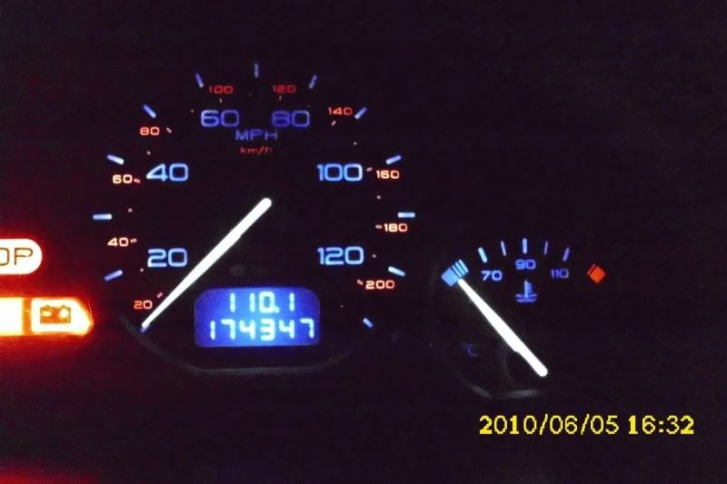

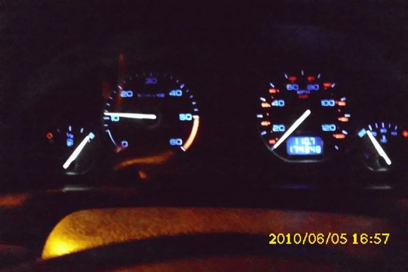

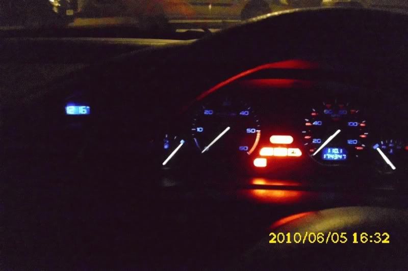

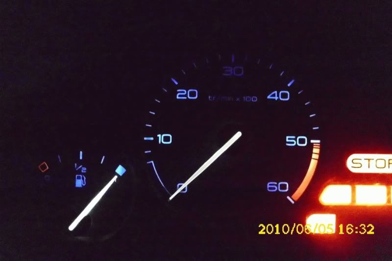

Right, I have rehashed phase 2 of my experimental project Illuminating Diode Integrated Optical Trickery.
Once again the camera doesn't really do the effect justice
Whereas in my previous attempt I simply superglued a bunch of blue cellophane on the back of me panel, this time I used the dark blue sticky-back plastic and diffuser film from Metal Monkey, plus proper white diodes. As you can see it's not perfect - the diodes don't light the top of the rev counter too well, and there are lighter patches due, I think, to the superglue I wasn't able to remove.
Also I had to remove one LED from its holder and solder it to the small bulb holder used in the clock, which was a headache (it was quite determined not to stick). It'll do though, I like it, the wife was impressed, and it's a one off. I can do an illustrated guide if anyone is interested.
