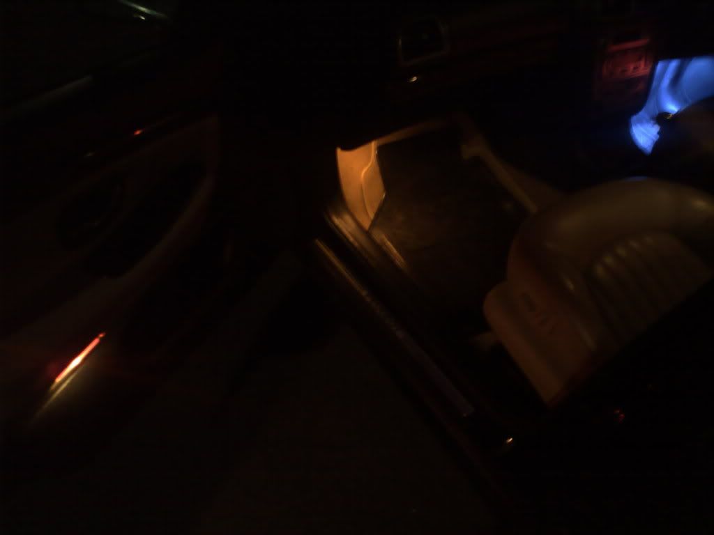

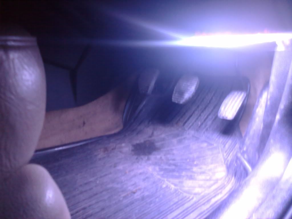

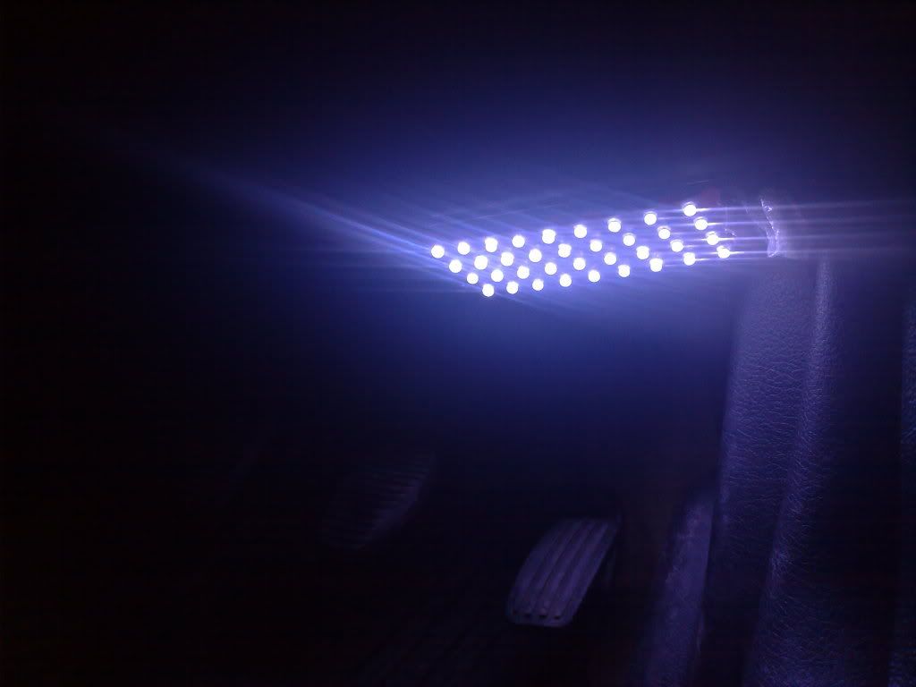

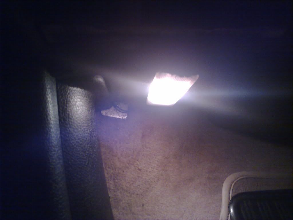

As you can see the led lights in the drivers footwell give off a different light and i think this helps explain why them energy efficent lights for the house still arent as good even though we are told they last longer, use less electricity and are brighter, they lack the 'Ambience' of the old fashoned bulbs and thats where the merc light on the passenger footwell is better, so given the chance i will put in a normal light into the drivers footwell.

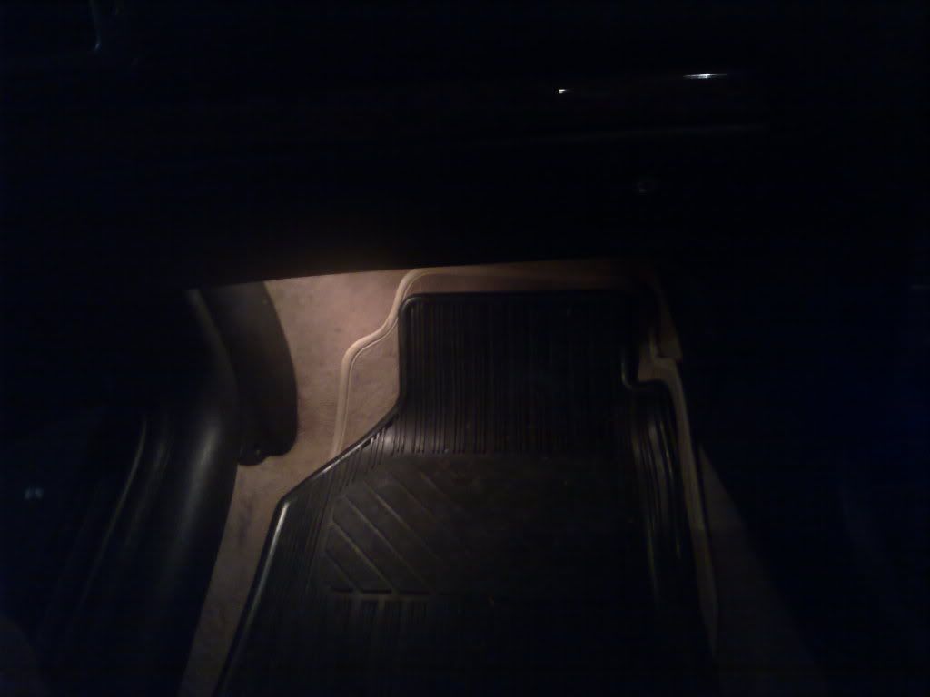

Heres the passenger side, getting a much nicer more inviting light shone upon it:

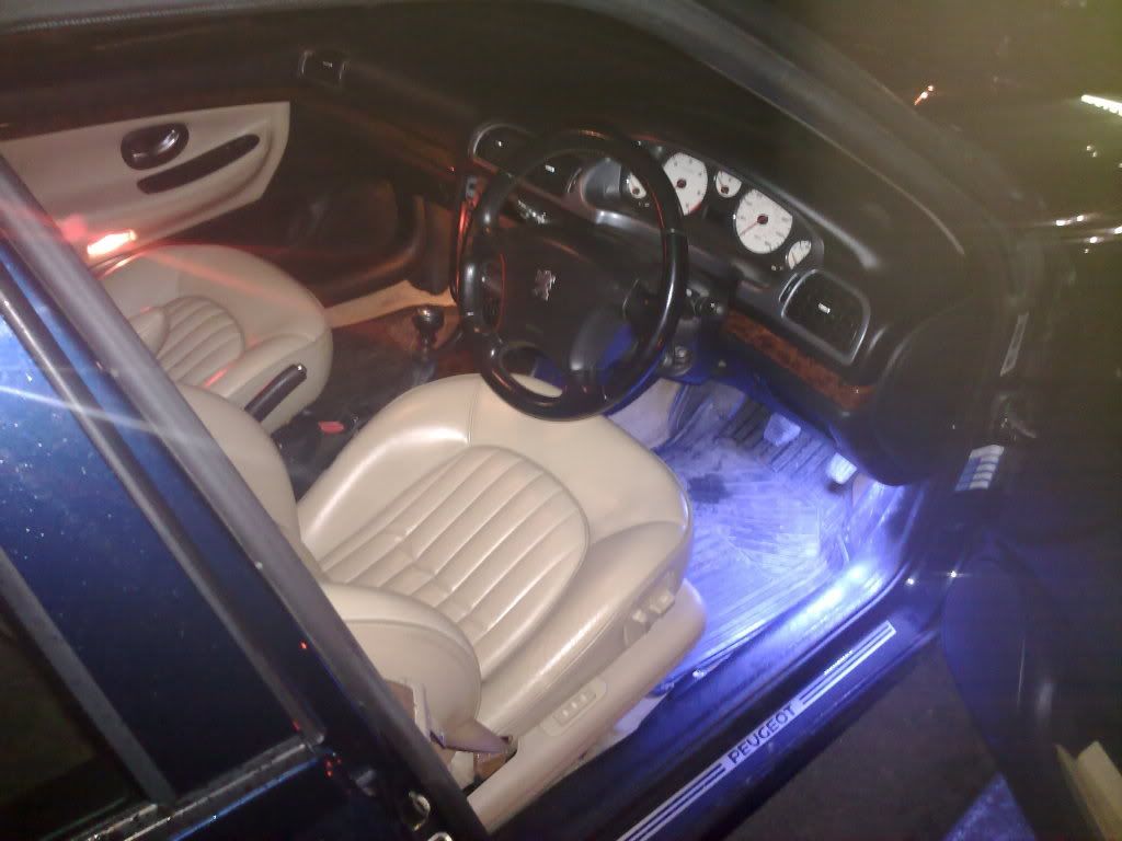

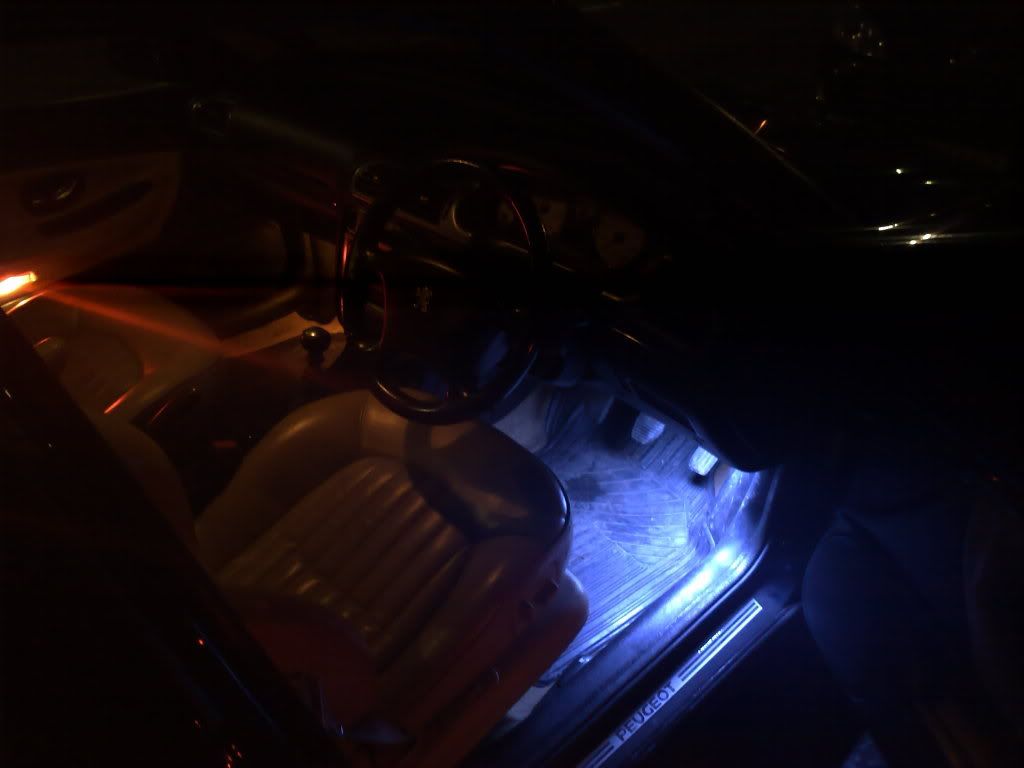

So thats it installed, sorry i dont have any pictures of installing it my n96 is broke and i only got the lend of a camera when i was finished, but its an easy job to do, just watch out you don't cut any wires for the alarm because i have found mine isn't working after this, but it cant be too serious.
