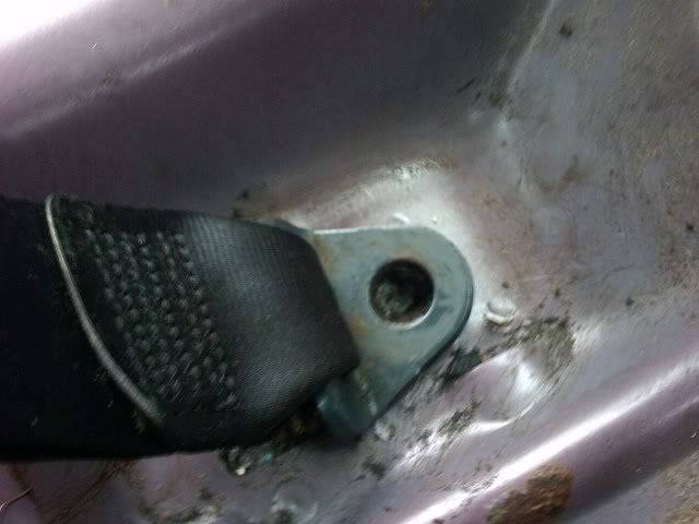

what can i do. ive managed to snap 1 of the bolts that holds the seatbelt clips in place :oops:
what the hell can i do. there is no way on earth that this will come out. it was really stiff to start with.
would welding it on be safe ?

In theory it would be as welding chassis sections is considered safe enough, but to be honest, I'd sooner replace the bolt - if you can get the remains out. Where was this bolted? Front, rear?
Re: SeatBelt Clip
this is for the passangers side rear belt.
just been to garage they said NO it cant be welded.
he said if he has to take fuel tank off it will be £45. if fuel tank doesnt need to come off it will be less.
he said he will replace it with a new nut and bolt :evil:

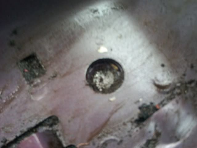

Drill a hole in the stub and invest in some 'easy outs'
2003 2.2 HDI SE
Re: SeatBelt Clip
easy outs wont work.
there is a reason why it snapped in the 1st place :mrgreen:
its stuck solid.
im gonna pay the garage to drill a big hole through it and use a nut and bolt and secure it that way.
after all £45 is nothing when it comes to the safety of my 7 year old son who sits there :D

its stuck solid mate. i have allready drilled a 6mm hole in the middle of it and it just will not budge.
best left to the garage i think on friday.
Re: SeatBelt Clip
You need to drill right thru it mate,
start off with small bits and work your way up,
it doesent matter if you take out the thread you can add a locking nut it wont afect the mot if its firmly anchored,
just keep drilling mate just have a nosey first and see if you have enough clearence and your not drilling thru the tank,
