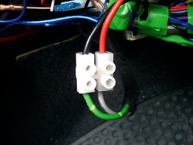

Gary406 wrote:under the glovebox is the main connector for the power. i would check here 1st its common for the connector start to melt
its directly under the fan behind the glovebox ..
it will probably look like this or worse . it could be this or something else. but its worth checking here 1st as its easiest
and using some 30amp connector blocks is what mine looks like now
this might sound like a stupid question, I take it the black and red cables are the power nad earth cables, if they where wired straight to battery, would if be on all the time, as want to test the fan
