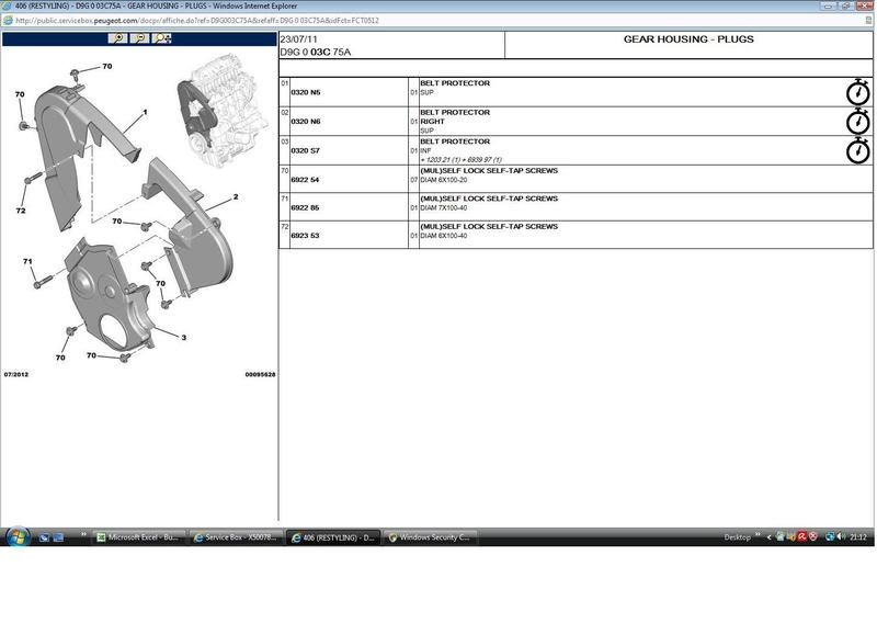

You only need the top bit of the timing cover off to check it, so it shouldn't take too long.
Re: PP2000 and timing?
That's what I thought but finding the hole for the TDC pin is another thing, but I'm going to have to do it. Can I get the top cover off without removing the engine mounting?
Pretty sure the engine mounting passes through the gap under the thin bit of the guard at the top, so you should be OK.
