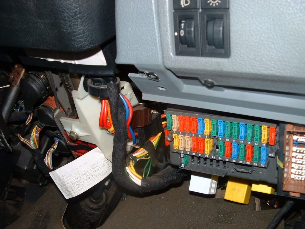

Just been and done that, and I couldn't see anything that didn't look factory. Took a quick pic to see if you can spot anything...
I'm wondering if there's a plug on back to front somewhere or t'other.

see that 30A fuse you've got in position 8? It should be a shunt not a fuse (just grab the biggest one you can find...) and it should be lower - in the middle between the 8 and 23 positions
You'll have to wire your stereo back to how it was... :)

Re: Permanent and Ignition Live Switched?
Here's a pic demonstrating where I mean on my old tubby. Fuses 1 and 16 can be moved down a notch for a permanent live too.

Right, sorry it took slightly longer than 5 mins, but I had to stick the battery back on the car as it's been on charge for the last few hours, and also put the lower part of the dash back on, but the good news is that it all works! You, my friend, are a bloomin' genius! I'm gonna go and swap the power wires back around for the stereo now and jobsagoodun! I now have courtesy lights and a clock that actually keeps the time! I think it needs a new bulb though as it didn't light up when I turned the ignition on, but that's no issue at all!
I'm guessing I'm not going to need to have fuse 1 or 16 in the permanent positions yet as everything in the car is still currently standard (won't stay that way for long though!).
Many thanks mate!
30A fuse put into spare fuse slots. I've got loads of spare fuses though, so I'm going to go and get one of each and stick them in the spares rack. Need to find my little fuse removal tool too...
