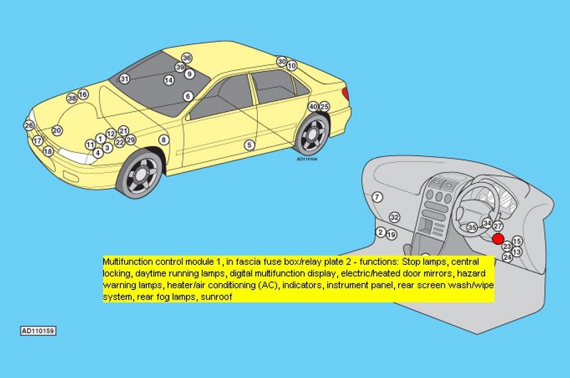

When looking at this wiring diagram from Autodata, it seems that Data Link Connector (OBD) is connecting to the airbag module through the BSI. Since you had tried to replace the airbag module and PP2000 still can't communicate to it, maybe the problem lies within the BSI.

Sorry since I can't edit my post again, it seems A11-I in that diagram refers to the module in the engine bay (I think it's called BM34? I'm not too familiar with full mux system) instead of BSI under the steering column.

Well, it seems my first post is the correct one. Airbag module connect to BSI under the steering column. :mrgreen:
