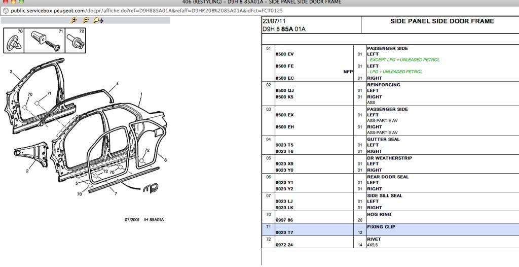

i didnt have a leak, i had a squeak in the a pillar, and the problem was the seal wasnt held down firmly enough, so i replaced these clips, i looked on servicebox the part number for the clips are 9023 T7
as for getting them i use this ebay seller to get clips etc:
http://www.ebay.co.uk/itm/180679211465? ... _691wt_907
ask them a question for the part number and they can give you a price, although so can any peugeot dealer.
Although despite the new clips i still get a bit of a leak from up around the A pillar corner, i think water gets in under the door seal, its definatley not through the sunroof, the windscreen is ok which leads me to believe that seal needs something behind it.
