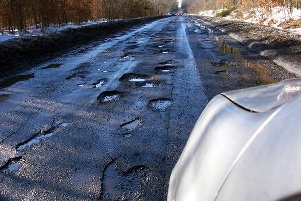

not one of my pics, but not unrealistic for a local post winter road by any stretch of the imagination :shock:
Re: Rear Wiper confusion
Nice and smooth then! :shock: :shock: :shock:
Flipping norra, I thought the roads around Woking were bad, sod riding a motorbike out near your neck of the woods in the dark!!!!
