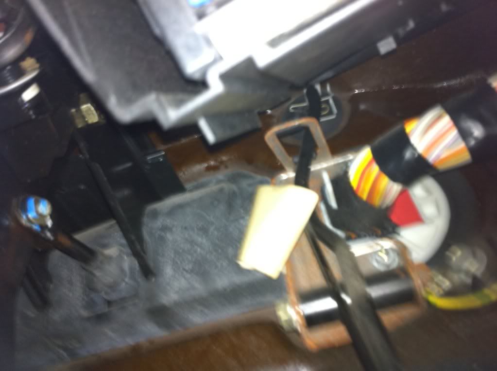

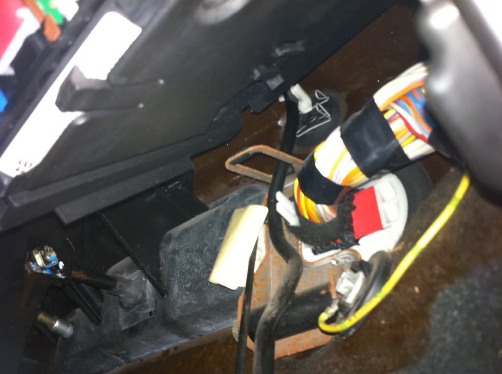

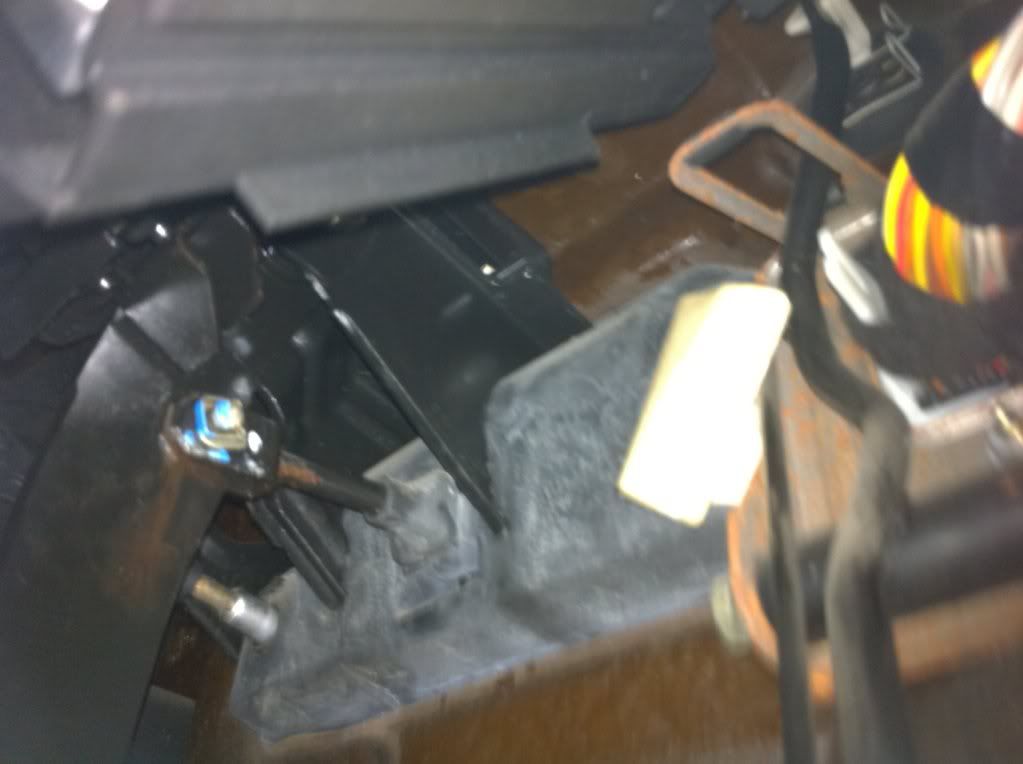

Well I still can't find that switch ... don't even know what it looks like really hope you guys can help PLEASE!!??
Heres a couple of pics of the area I think ...

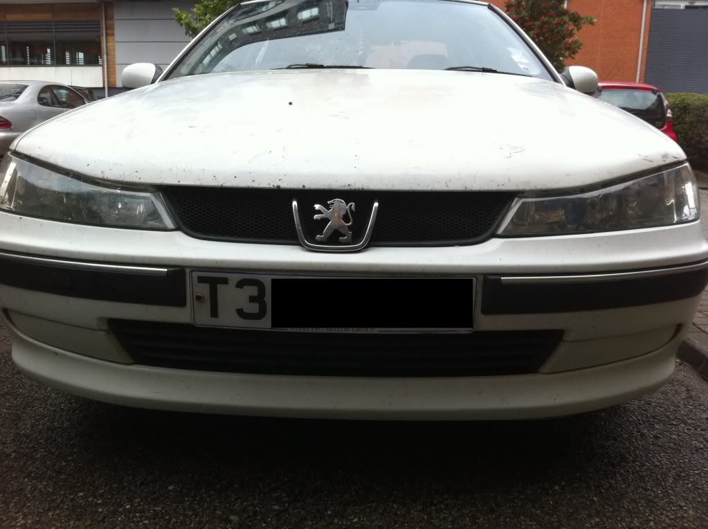

and here's what my grill looks like

Yours is a D9, probably one of the last T-reg models, and definitely one of the first D9s.

Re: Urgent Help needed
Look at the first two pictures.
It's hard to tell from the photos, but look just above the nut covered with blue threadlocker (I hope that's the brake pedal else I'm going to look daft here! :shock:). You can see a curved section (inverted 'U' shape bit of metal) attached to the pedal metal, and just above that you can see something shiny. I suspect this is the switch (or one of them if you've got cruise control).
The switch is NOT mounted on the pedal, it's on a separate bracket, and it's a pretty small plastic affair with a threaded bit (visible on the 2nd picture) where it goes through the hole in the bracket.
If you yank the switch from the bracket, with the ignition on, the brake lights should light.

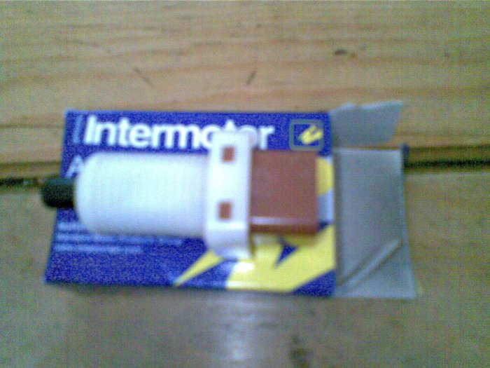

Just though I would let you know I FOUND THE SWITCH (spending so much time on my head :? )!!! Went to Europarts, £5 later walked away with one and fitted it and guess what ... I have my brake lights back!! Thank you all so much!! :cheesy:

Post by mattyf »
Yeah it is weird ... put the two sitches together and the new one stuck out just that little bit further and couldn't pull the old one out to match .. weird!! :frown:
