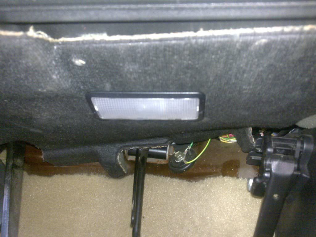

I got the drivers side light sorted, its one out of a 206:
i did some thinking and thought that if i got an independant power supply from the battery then it wouldnt affect the battery but then there is the issue of swithcing the lights on, so i thought of just hooking it up to the door switches, went to have a look and they dont exhist on car must be something integrated into the locks, so then i thought of adding ones to the car but that would be a proper hassle having to drill a hole and install each plunger and they might not even fit in the place right so now im back at the though of using the puddle light, because i still have the two wires sitting there if i reconnect the footwell lights it will make the bsi go bonkers but if i connect a multimeter it doesnt, so is there some device which will know there is power coming from the puddle lights and electronically switch on the footwell lights in effect a relay which doesnt annoy the bsi.
