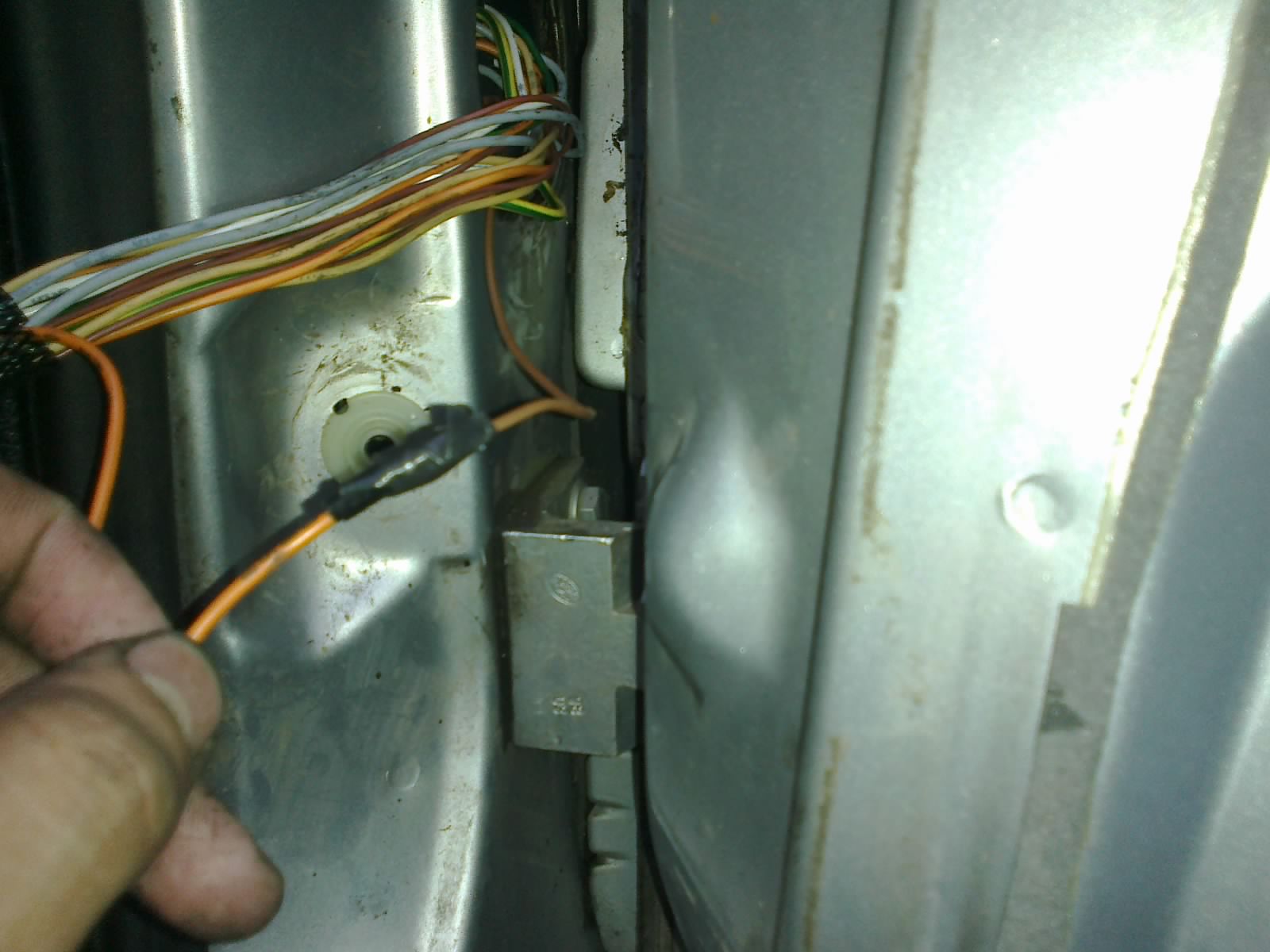

by dgt » Mon Jul 09, 2012 2:23 am
Oh dear... My window woes came back and bit me in the behind!
Drastic measures. I whipped out the loom from the door
Traced the wires back. Found out the wire at the door had split in half, seemed too short... So I got it sorted with some longer wire
Both windows now work like a dream
