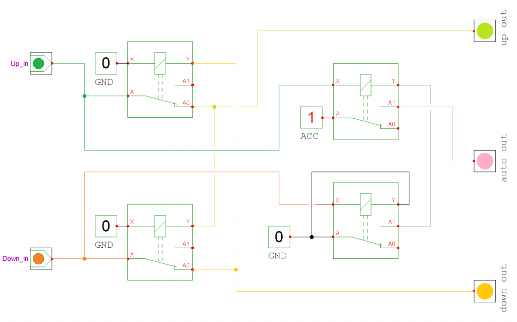

Mine is allmost fully working, but automatic window up and down is not working & mirrors neither.
- 1.6 8v
- Posts: 16
- Joined: Mon Aug 20, 2012 3:07 pm
- Location: Finland
Re: d9 door cards in d8 how to
I got it finally working, to get frontwindow fully working (automatic) u need to do that with 4 relays. Allso rearwindow "killer switch" need 1 relay too.
Here is picture about drivers switch relays.
