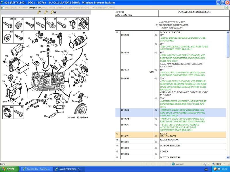

Re: D9 2.0 HDi 110 Cruise Control Activation
I'm guessing you'll want 1938S4, but it is a guess and.......
Reference Description Quantity Price - VAT Price + VAT Total + VAT Selection
00001938S4 INJ CALCULATOR 805.76 GBP 805.76 GBP 966.91 GBP 966.91 GBP 966.91 GBP
you won't want one from Pug, (bear in mind, it still needs configuring to your car).
