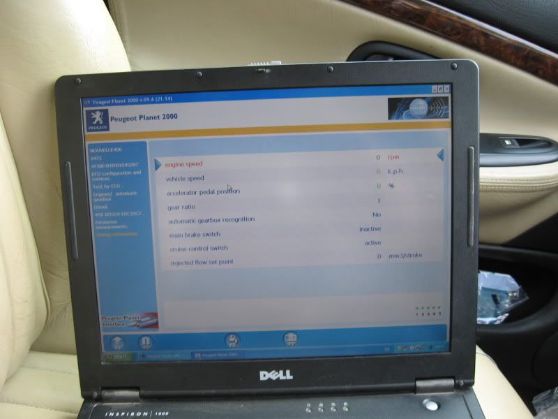

Thanks Doggy, I got two brake switches now. A red one and a white one. When you say coherence, is one ment to be advanced compared to the other by means of adjusting the gap? As I think this is the thing I'm chasing.

Re: Cruise control 2003 406S estate installation.
Yes, that's it- see below:
In the above picture, I have the brake pedal pressed slightly and you can see it says,
'main brake switch..........................inactive'
'cruise control switch.........................active'
both should say inactive until you press the pedal, then the 'cruise control switch' should close first, followed by the 'main brake switch'. You should get the inverse as you slowly release the pedal.

Cracking job just tried it out, boy does it feel weird! Is there any indicator/ readout for it or is it speedo only? Its all a bit new to me :-)
Feels like its working ok though get upto 50mph flick it on and set+ and she takes over. Thanks again for your help Doggy how do you keep a cream interior cream? (Can't be easy lol that's why mines black)
