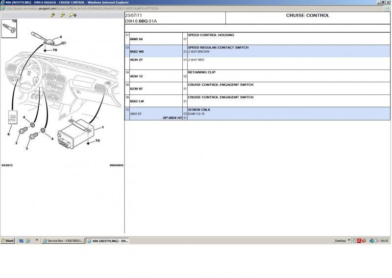

Re: cruise control not working
This is what Service Box shows for your car:
which confirms a separate control unit dedicated to cruise control, so I guess you should be able to find it with PP2k.

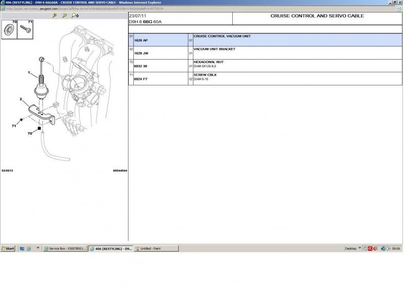

This is what Service Box shows for every damn car, for some things the filter doesn't actually do anythingDoggy wrote:This is what Service Box shows for your car:
From your VIN your build code is 08997, which is 3 days before they went fulll-mux
TRIM LEVEL UPPER MEDIUM PLUS
Serdre's telling me for that build code it could either have a control unit (Sirius 80?) or it could just be run off of the ECU/BSI, although after spending ages looking for it I couldn't find this ECU on the diagram, so I went and looked at the "absence of this variant" diagram to see if I could spot the difference and there it was
