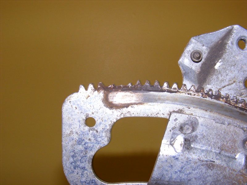

Re: 406 COUPE DRIVERS WINDOW WON'T SHUT COMPLETELY
They might well be right. (about the fault, not the stupid price you've been quoted).
If you're reasonably handy with tools, this can be sorted relatively easily. Get a used, but good regulator from Adrian Bingham who is a trusted source of used parts.....he goes by the name of 'ade1122' over on the Coupe forum ( http://www.406coupeclub.org ), where you will also find a useful 'How-To'.
http://www.ebay.co.uk/itm/PEUGEOT-406-C ... 4d019e826b
Also, if you put your location up, there might be someone local willing to help out.
Your regulator teeth might look like this......
