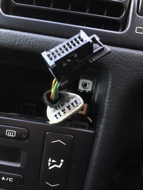

Do you know, once you activate the CD changer port via pp2000, does the MFD 'remember' this so that it will be compatible if swapped to another car with a cd changer? As I said yesterday, the original MFD in mine was responding and seeing the cd changer but the one I acquired to swap it for would not. Therefore, if the BSI in my car already had the cd changer activated, I would assume it must be MFD that needs telling and then it would 'remember' - is that the case?
Thank you for clarifying the two types of MFD too. I saw a couple of the type C versions in two other cars at the scrappies but left them alone as they were not what I was after. Out of curiousity though, I noticed when I removed my type B that there was an additional plug there alongside the one which mates into the type B. What might this be for - sat nav control maybe? Looks like this (I'm referring to the grey multiplug below and behind the black one.)

Hmm, to be honest its nothing I've really thought about.
I guess if the scrapyard car hadn't been fitted with a CD changer, then I the BSI hadn't programmed the MFD to accommodate one - easy to sort with PP2000
Don't worry about the spare connector, all my 406s had them and they weren't plugged into anything...
