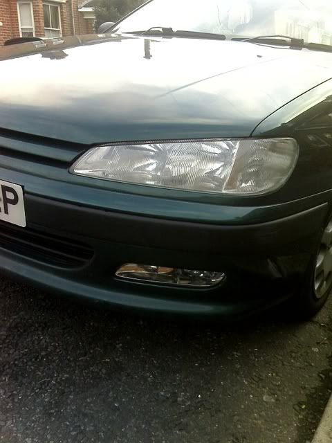

Morning sports fans. So I've seen folks with small lights below their main lights... on mine it's just blanked off with small panels (see attached pic). I was wondering how a chap would go about popping lights in there for added awesomeness. My tool kit is a) rubbish and b) rusted to hell but I figure I can always improvise with cooking equipment etc :)
Cheers dudes.

think its just std foglights how easy they are to fit i have no idea but i figure a visit to the local scrappy is gonna be the cheapest bet

OK, so I've re-opened this project file.
Tomorrow, weather permitting, I intend to:
  • 1. Jack up the front of the motor and examine the current set-up - how are the blanks secured and is there space to fit the new units?
    2. Take a mosey on over to the scrappy and try to extract the required parts from a wreck.
    3. Fit them on my own car.
Some questions, if you're not all bored with me yet :)
  • a) Ian suggested these smaller units are 'standard foglights'. Excuse me for being slow, but I'd like to be perfectly clear: are these 'foglights' different to the main beams? Are they a separate feature? When I hit the foglights on my control stalk, I only have extra lights come on at the arse end (it's an LX). Does this mean I don't have foglights on my sharp end?
    b) I intend to set these new units up as headlights, to 'compliment' my beams. Assuming they'd fit, can I install bulbs identical to my regular beams in the new units and expect them to respond like my regular dipped/mains?
    c) Assuming I work safely and properly insulate the work afterwards, can I simply cut the existing lines to the headlight clusters and crimp on lines going down to the new units?
    d) If I do this, should I consider upgrading the fuse? I calculate the headlight bulbs draw about 0.2A and I think it'd be ok as it is.
OK, think that's it for now. Appreciate any advice.

swiss wrote:a) Ian suggested these smaller units are 'standard foglights'. Excuse me for being slow, but I'd like to be perfectly clear: are these 'foglights' different to the main beams? Are they a separate feature? When I hit the foglights on my control stalk, I only have extra lights come on at the arse end (it's an LX). Does this mean I don't have foglights on my sharp end?
I think UK cars are legally required to have a rear foglamp. Fronts are optional. They ARE different to the headlamps, they're mounted close to the ground, run off separate 10A feeds (one per lamp) from the engine bay fusebox, they have a very narrow spread vertically and large horizontally so they illuminate as little fog and as much at the side of the road as possible. Due to this they are capable of seriously blinding oncoming vehicles over the crest of a hill and are illegal to operate outside of foggy conditions
DON'T. They're designed to cut through thick fog. You use them with your headlamps OFF.
No. You'll halve the brightness of your headlamps. They need a separate switched high current feed. You'll want a light stalk with front+rear fog settings, a relay, and a spot of wiring
The lights you see on the front of rally/offroad vehicles are floodlights. They're highly illegal to use on the road in (probably) every country with tarmac roads and compared to 10A headlights/foglights chew up around 150A. Each. They're used as "super main beams" and the chances are your 406 would have fun providing enough power to drive the alternator required to light them :)

The wiring is already in place; I intended to fit front fogs to my LX before it was written off.
As mjb says you'll need the stalk with front fog function and the relay.
If you don't have any luck at the breakers I've got a brand new set of D8 front fogs, you'll just need the other bits.

Well, got me down the scrappy this morning. Found two D8s with fogs. Removed the offside unit from one and realised its nearside lens was smashed. So I went around to the other car, which was up on a rack. Gave me good access to the fog unit. However, when I finally got the spring released, the frakker fell eight feet on to the concrete :(
So now I've got one complete fog light unit and I'm scouring the web for another ^^

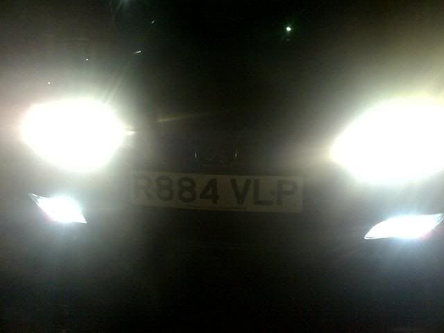

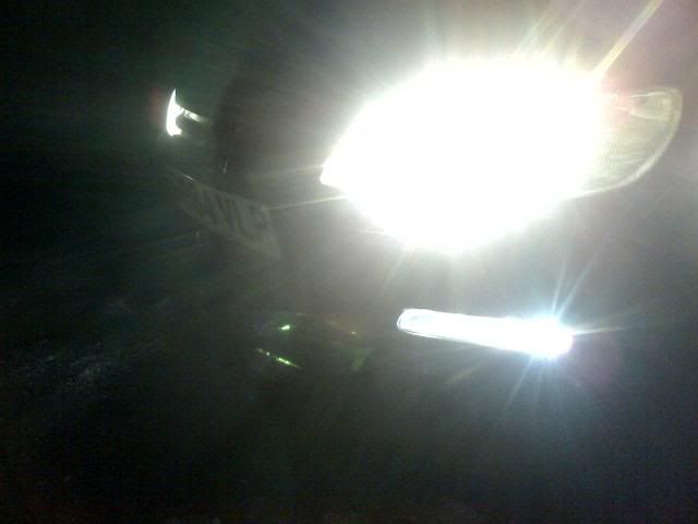

Woo hoo!
Thanks to all those who helped out with this.
No more modding 'till I get a garage!
