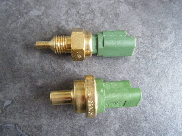

Ok,
Came to do this job and it would appear to be a part which may be wrongly listed by Intermotor.
Or there may be other versions on HDi models.
So off I went to the local dealer and got the correct one.
On mine its the lower of the two which is held in by a sliding clip
The top is the Intermotor supplied which was oddly enough ..dearer than the dealer.
Same electrical plug fitting but thats all!!
Tony
