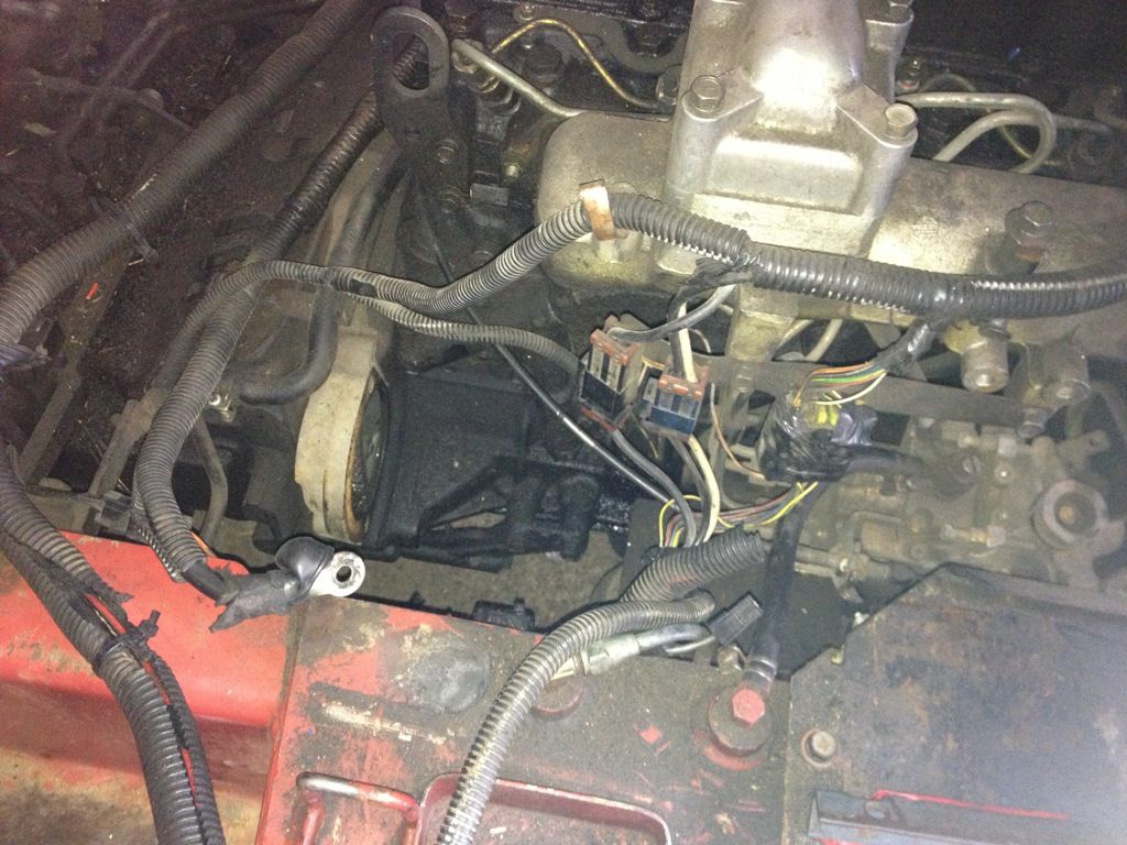

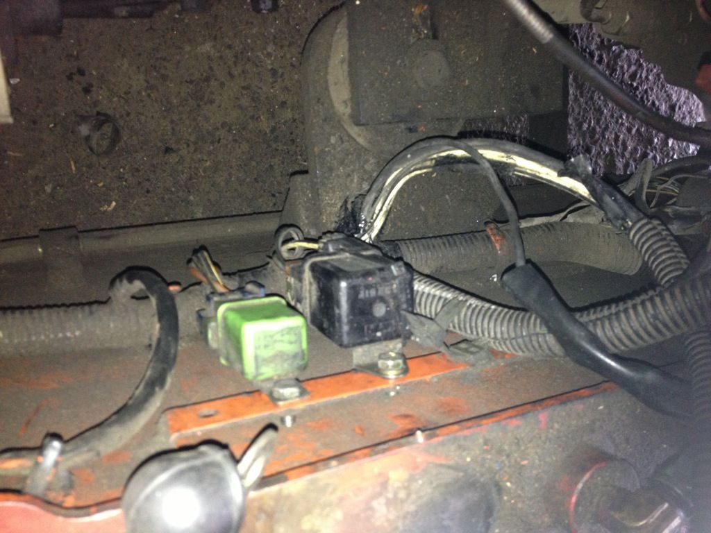

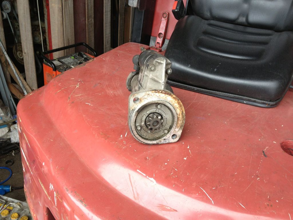

I checked all the wiring, all seems to be in alright condition, there was 12v going to the solenoid when the key was turned so it rules out the switch, i just pulled off the starter and it can get fixed at a place up the road for about £30
The wire that goes to the top of the solenoid goes back to this relay which was a part i was suspecting but its clicking on and off ok:

Got the starter back, apparently nothing wrong with it, the battery seems to be Fecked though, apparently it was jump started from a 24v lorry a couple of weeks back, what would that have ruined?

We spent a few hours today at the forklift, found out that a section of the wiring loom had been burnt so the glow plugs, fuel solenoid and starter were not working right, there was a wrecked relay for the glow plugs keeping them constantly on running the battery down, so new wires were added in, and a new relay the forklifts now starting ok.
