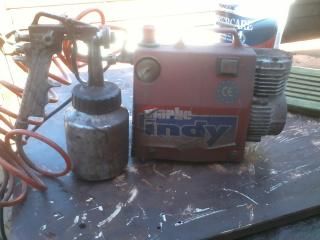

Not sure what means what (apart from the obvious ones) but here's what's on the sticker.
Type= Indy
V= 230
Ins= F Kw= 0.33
Hz= 50 A= 2
Ph= 1 Hp= 0.5
Air displacement: 100 litre/min
Maximum pressure: 8 bar (115psi)
Dunno if that means anything to you. :lol:
Some pics.

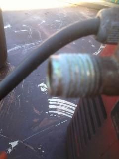

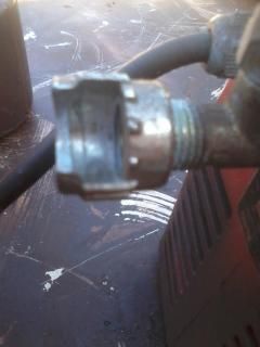

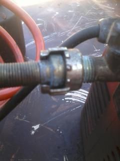

Connectors.
The last pic is what's left after the connector is removed now I'm thinking i can get a hose to screw straight onto that with a quick release standard fitting at the buisness end but i might be wrong?

100 litres/minute is 3.53cfm, not very much. I think most spray guns take about 8? Hold on http://www.machinemart.co.uk/shop/produ ... -spray-gun Maybe?
scotty73 wrote:...a quick release standard fitting
You'd think there'd be a standard but I already found there's about 4 different ones :roll:
Re: Air compressor "help"
steve_earwig wrote: You'd think there'd be a standard but I already found there's about 4 different ones :roll:
I might be wrong here (If I'm not then i feel a right twat) :supafrisk: but the connector that's in pic 2 being what i think is a half inch fitting will screw onto the screw in type guns without replacing anything. :supafrisk:
