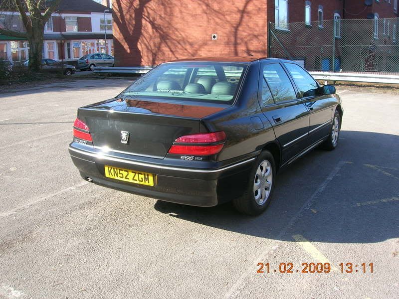

Welp, picked my lovely new-old 406 exec and it's great. Had a drive from Coventry down to London and here are my initial thoughts on it.

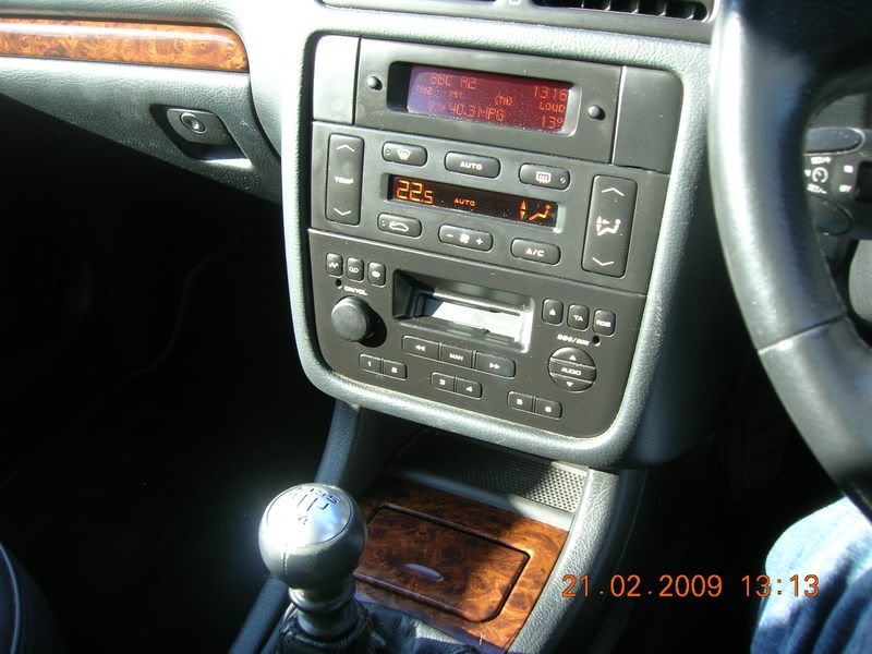

4) Clarion/JBL sound system is "OK" and certainly good enough for 90% of folks. I am, however, used to sound quality prduced by Alpine HU's, PG/RF amps and Focal components, so that will be ripped out. The handbook even has a wiring diagram for audio harness - amazing.

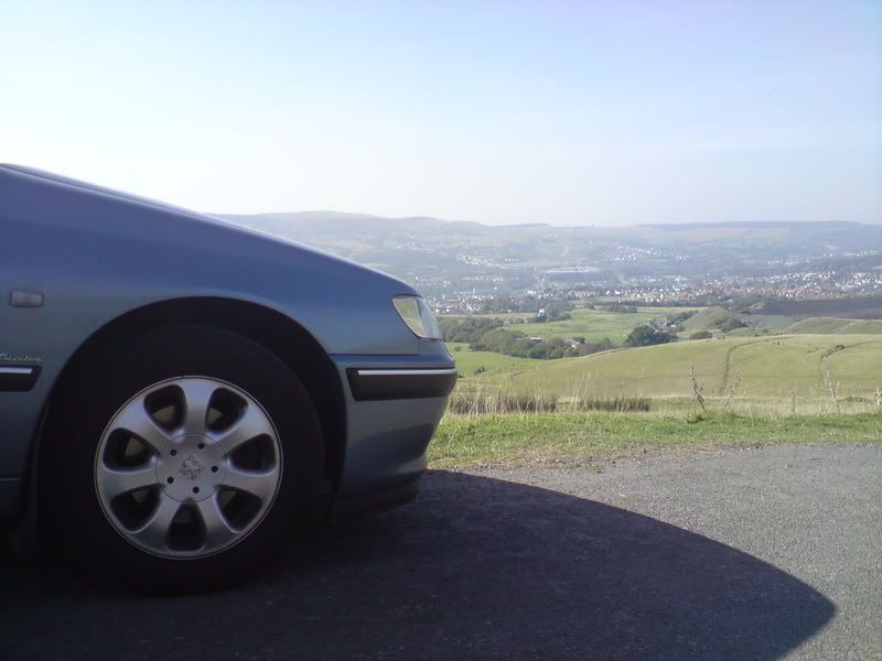

1) Wheels are not tracking properly. It doesn't steer sideways but going straight requires the steering wheel to be slightly to the right.
2) Wheels juddering going at speed (>70mph). Either down to balancing or the crap tyres - P6000's. Yeah, I know they are not technically crap but I these same tyres on the old '6 and had exactly the same problem. Firestones seem to suit this car better. There's plenty of thread left though, so I won't bother replacing these just yet.

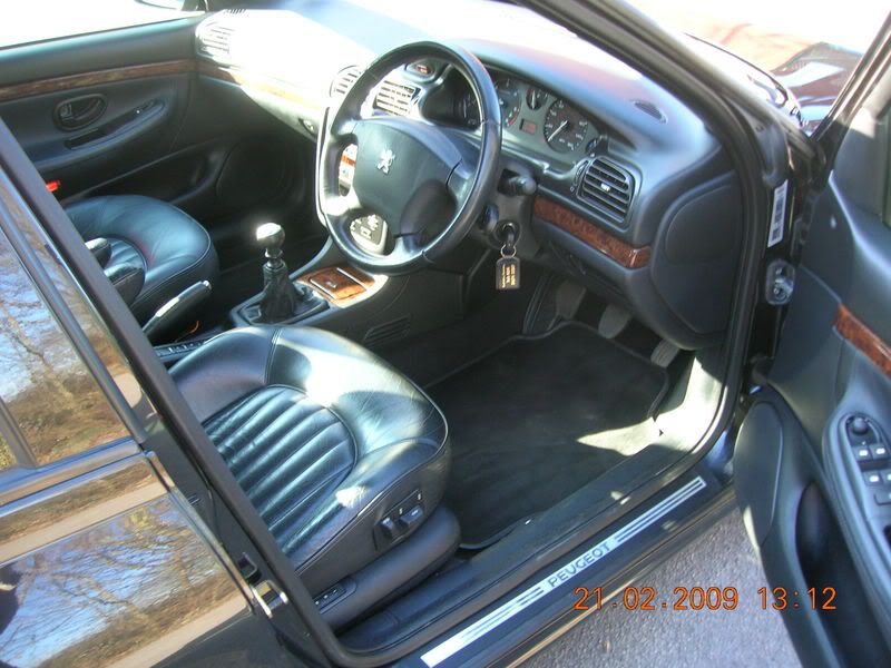

3) I am convinced there's something wrong with the gear linkage as, no less than 4 times, I have accidentally selected 4th gear rather than 2nd. Even going from 1st to 2nd sometimes selects 4th. Going from 5th to 2nd is also vague and you have to consciously push it in. In gear the gear stick seems to be a little wobbly too, but there's no problem actually getting the gear in. Any ideas?

Nice set of wheels, Captain! 8)
Are those 5-stud alloys? I thought the 406 would only take 4-stud wheels.
Also - why not make yourself a members page on the new Wiki? Instructions are at http://www.pug406.com/wiki/index.php/Ca ... mbers_Cars :cheesy:
Re: My new ride
It cost.. a lot.. £3750. But it's in a very good condition (bar the above!) and hopefully will last me for a long time.
It is 5 studded. I didn't actually notice until you told me :? Didn't realise 406s came with 5 studs either.

Captain Jack wrote:It is 5 studded. I didn't actually notice until you told me :? Didn't realise 406s came with 5 studs either.
Nah they're just lying centre caps fella, the wheels themselves are 4 stud. :wink:

I'll see if the gearstick moves when accelerating - is it a hard job to fix it? Are these mounting of the actual gear stick or something else?
Another little problem I noticed was that the horn didn't work very well. I had to press the steering wheel in quite a specific place to get it working. I guess that's just bad contact somewhere in the wheel. Anyone come across that?
Re: My new ride
Looks smuckin fart Cap'n 8)
My gearchange is OK, but I did get 4th instead of 2nd quite a few times when I first got it - put it down to unfamiliarity & armrest interference, almost never do it now. (It's a cable operated gear change, so maybe could be adjusted).
The horn on mine needs a fairly determined shove & I seem to remember Dai complaining of a delay on his.

DaiRees wrote:Nah they're just lying centre caps fella, the wheels themselves are 4 stud. :wink:
WHYYYYY? If they wanted 5 stud wheels why didn't they just put them on the car instead of using 4 stud then faking it?!? Bloody French... :lol:

I think the 5 stud thing is a 'macho' thing with cars. Theres no need for more than 4 on 15" or 16" wheels.

1. Get tracking done.
2. Get wheels balanced.
Maybe that should be in reverse order in case there's something wrong with a tyre...
3. I don't think you can adjust anything, I suppose you could try greasing up the ball pins on the mech on top of the box and see if that does anything. Actually, I have a suspicion I did that a few times when I first got my D9. I can't remember a wobbly gear stick, I guess it would be good to check it out but it rather involves removing the exhaust. The only problem I have now is I'm used to leaving the D8 in gear and starting it with the clutch down - note that reverse is now right next to first. The procedure is get in car, key in, foot on clutch, reach down to check car is in first, start car, pull away backwards... :oops:
