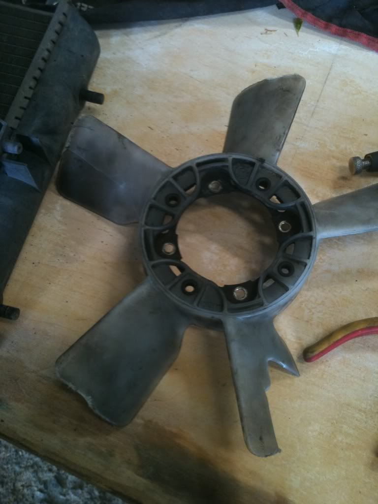

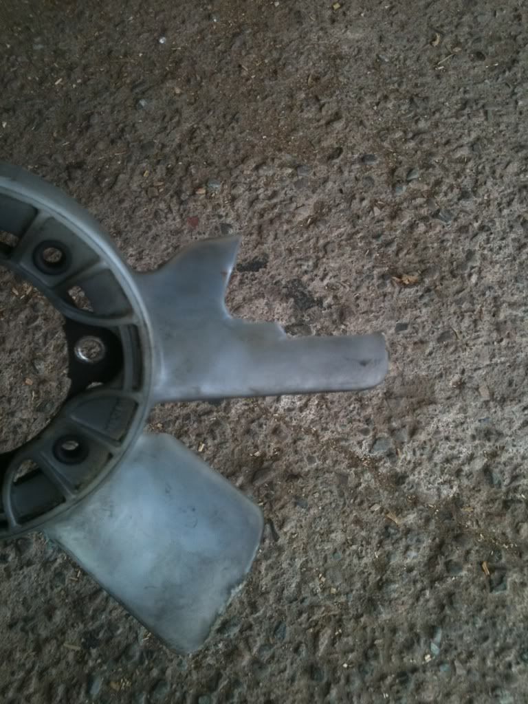

here is the old fan that caused the trouble:
