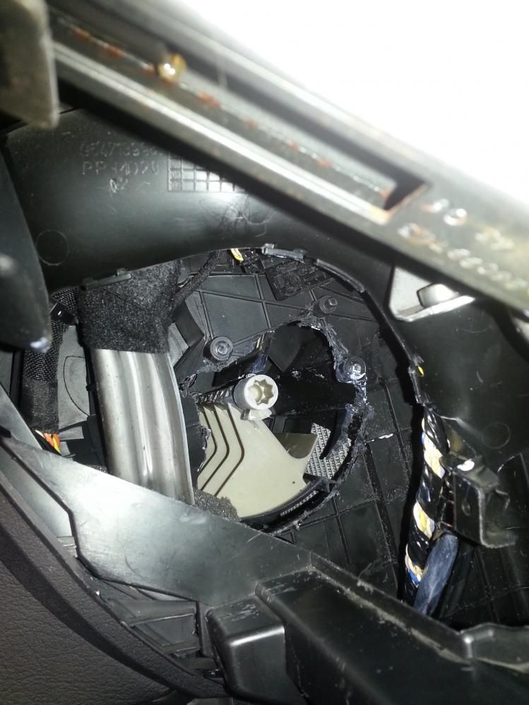

Welp, the seller definitely knew that the heater flaps were broken :roll: The motor controlling the flap had been undone and the AV input for the radio, which normally resides in the glovebox was BEHIND it. Only today I figured out I had an aux-input after all! Sounds like he's been told it's a dash out job.. costing £2000.. but I just cut into the heater box to remove and fix the flap. A bit of a pain due to lack of space and proper tools (crap Dremel) but it's doable.

The flaps live here, behind the centre console in the heater box (driver's side shown here - view from under the steering wheel):

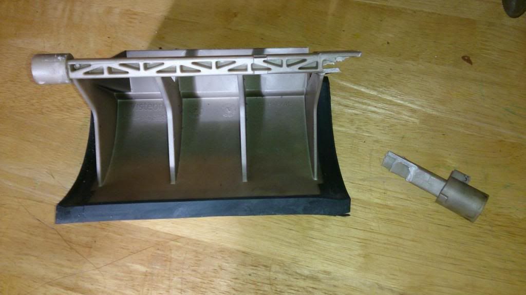

They are rotated by a motor to control the air temperature coming out of vents. Sadly, they are made of cheese, so the flap shaft breaks...

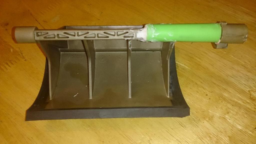

Fixed by lots and lots of glue/epoxy:

Wow! what a job :frown:
So do you not get heating when this is broken?
And you have to fashion a new cover after you 'butchered' the heater box? :cheesy:

Depends on the model. I have a dual climate thing, so the driver's side is OK but passenger is blowing cold all the time.
I just put the bit I cut out back in with even more glue.

I had a fun day. Went to refit everything but before gluing the side back on, I thought I would see that the motor is synced/aligned correctly with how far it should move the flaps. I was quite surprised to see that the motor tried moving well beyond the limits of the flap movement. At first I thought that the motor was shagged or something wasn't counting pulses correctly but... not so. I took off the driver's side motor, which works fine, and saw that it did the exact same thing!
So, it looks like every time a battery is reconnected (or whatever other event), the motors calibrate themselves by finding limits of how far they can move in each direction. Sounds sensible but it does it by literally forcing the flaps against their stops inside the heater box. It's THIS process that breaks the shafts. Urgh....
