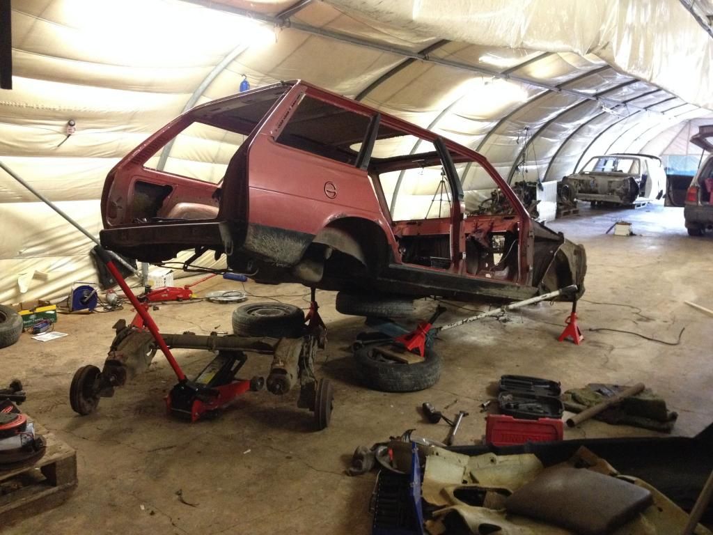

The car now has no parts attached to it as of today, the back axle and fuel tank came out today:
This was my cousins idea for lifting the back axle out, not very safe looking but then the 305 body with nothing attached is extremely light.
The axle came out handily enough, disconnect the one brake pipe, two handbrake cables, 6 nuts and it drops down.
This is it back down on the ground, with pallets under it to make it easier to move about.

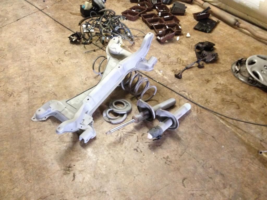

My cousin also got his sandblaster working again so the subframe, front springs and shocks got blasted and are looking quite nice:
