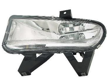

on the issue of getting the foglights out here is a picture of one out:
the top bolt is the issue.
