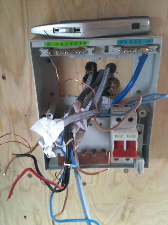

its not live yet so dont be scared at the neatness of the wires,
anyhow, i cant use any of my uncles breakers on this, ive had to order some wylex ones.
Do the earths need to be insulated?

farmer yes the earths need to be insulated.

ah right, ive got some insulation sleeving sitting about, why are they not insulated as standard?
Re: Electrician Help Please.
in the cable they dont need to be, its only the bare ends that are on show that need to be covered now .

also is that copper bar, its sharing the live between the other 5 trips?

The copper bar is the busbar that joins the mcb's to the main breaker or rcd.
Frank you haven't got an rcd fitted in that board, are you going to wire one in series before the dizzy board or squeeze one in there? Your lighting circuit should not be rcd protected but everything else is.
BTW your incoming is 2.5mm, you want to watch that! Run another cable in parallel back to the feed point to turn it into a ring. Also check what size breaker the spur to the shed is coming off; there's no point wiring up 32's in your new board if the feed is connected to a 16!
