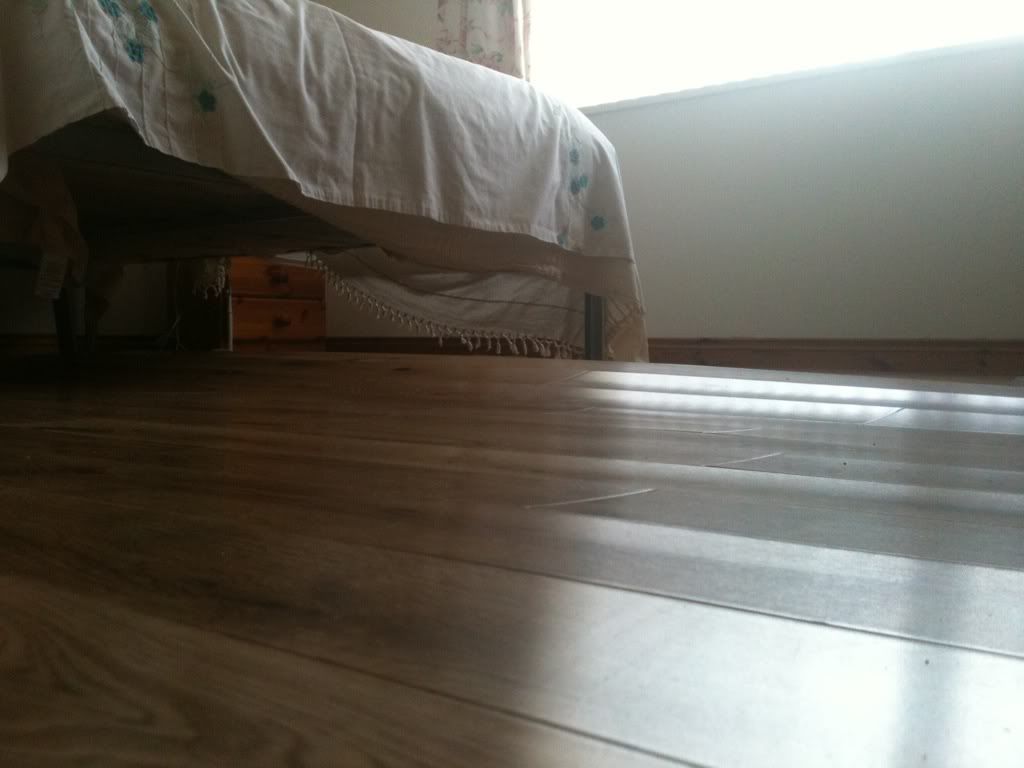

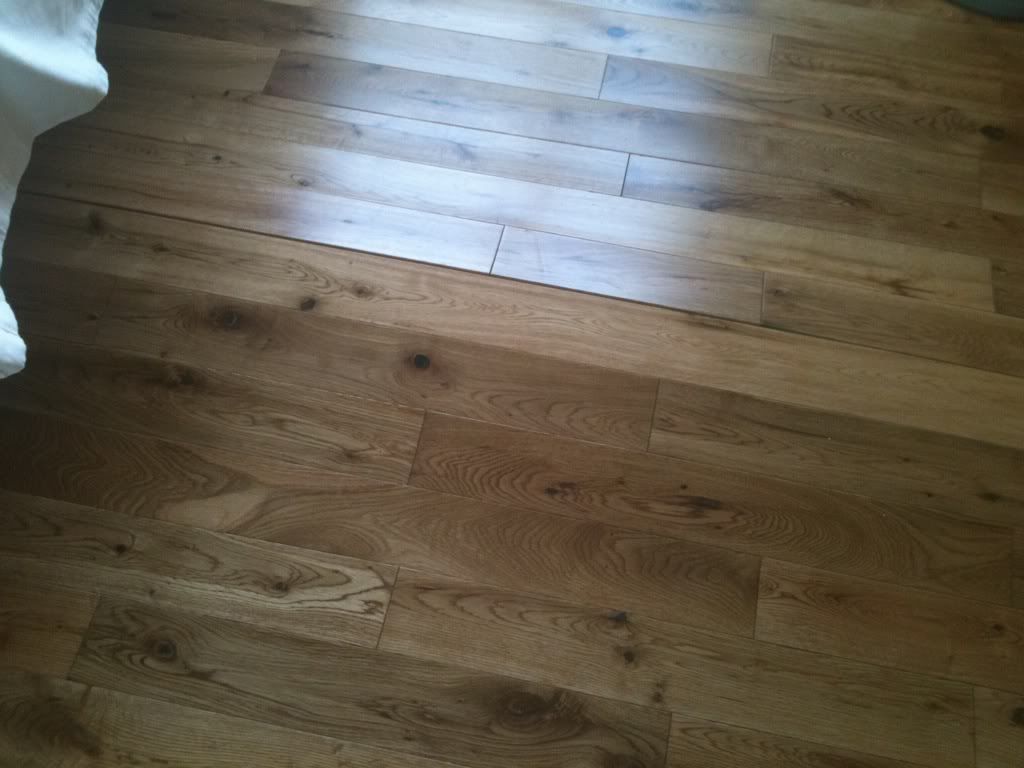

on the topic of flooring this has happened recently in my mums bedroom:
this bedroom got badly flooded on boxing day when a pipe above it burst, and the old floor went up really high, it was just ripped out and replaced with this one by an uncle who is a carpenter and has the time to be working with these solid wooden floors. Hes going to sort it out, but we didnt expect this to come back

i'm re-doing my mums downstairs on tuesday because of water damage.
frank it shouldnt lift so high ? my mums house was badly flooded and only the edges of the wood curled up ?
did you leave a gap around the sides or did you but it straight upto wall ?
Re: Laminate flooring
there was a gap round the edge but its probably not enough

what we usually do is reccomend new skurting boards going on after the new floor is put down.
beeding is ok and looks good if done properly but skurting board is always better.
leave a 10mm gap around the sides all the way round. every wall it needs to be 10mm away. or the maximum it can go so that the new skurting board or beeding will cover the gap over . some skurting board may only cover 8mm away from the wall .
this then gives you 20mm of movement allowance,
but if any floor gets flooded on it will need replacing anyway. but still leave the gap because wood expands anyway .
I've done the front room, hall, and lad's bedroom, and replaced skirting in all 3 rooms
I've already replaced skirting in our bedroom once, but sod it, it will all match around the house at this rate
The only place i've used beeding is against the french doors in front room as no other choice
