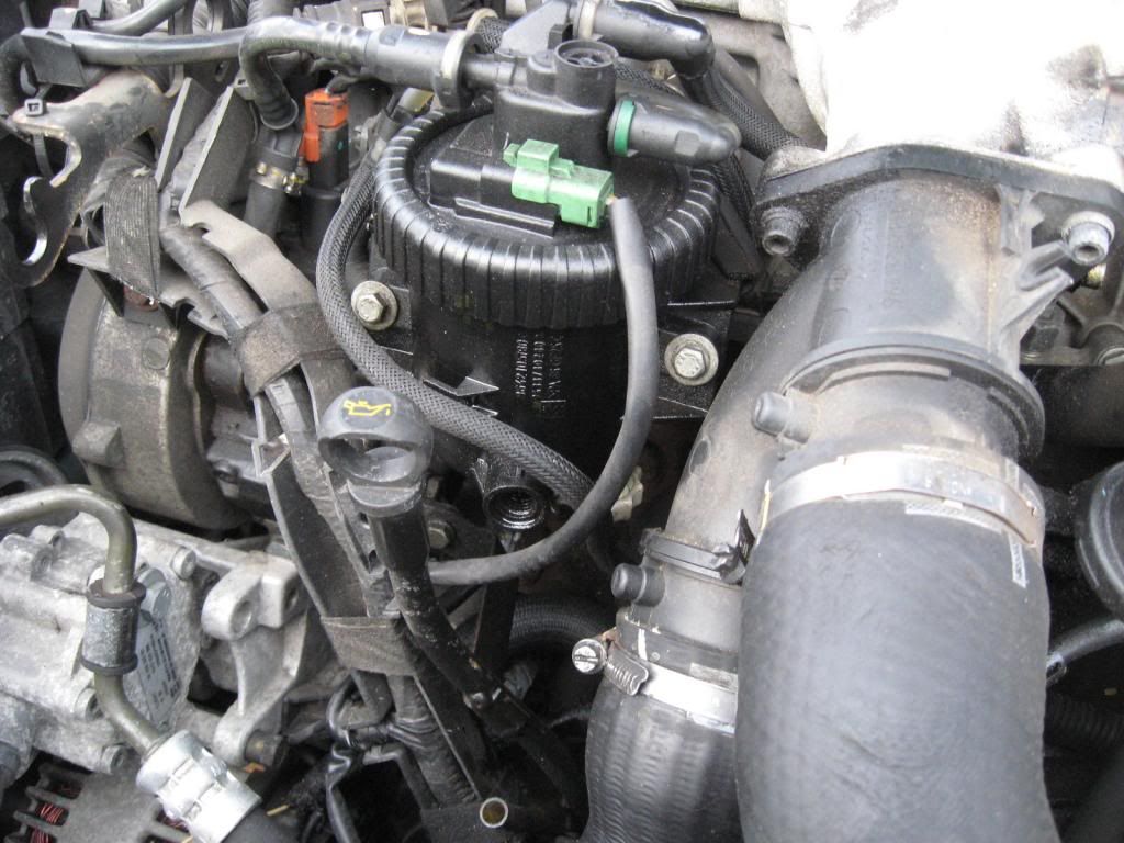

Well, here's the fuel leak......
Looks like it's seeping past the seal under the lid, (thought it was the shiny bit on the top q/r connector, but that's just been rubbing on the acoustic hood). Guess I'll try swapping the filter first.

[quote="Doggy"]Well, here's the fuel leak......
It's the exact same place that mine has the leak,i first noticed it back in August when we were on holiday in Cornwall and i was loathed to try and tighten it up there just in case i made it worse and it's still on the little jobs to do list,i was going to try and source a good used filter housing and change the lot as the locking ring on mine is a bit butchered.
