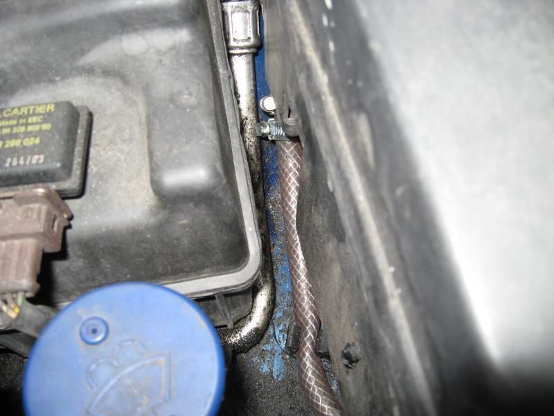

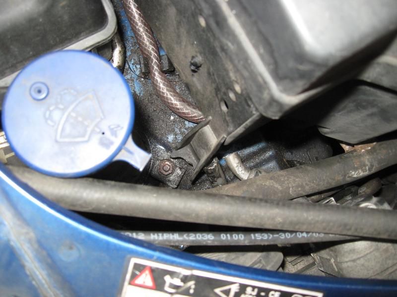

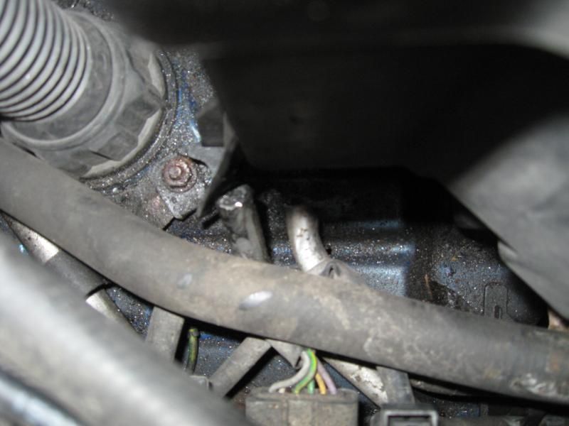

and now, the power steering pipework massacre.
Noticed oily stains on the front of the engine and around the power steering reservoir when we picked it up....
...but didn't see this till after we got back.
Nice.
The seller described having had a leak and the garage having several goes at fixing it, eventually 'replacing everything'. Shortly afterwards the alternator failed, (mine did this after being drenched in diesel, so P/S fluid could easily do the same). Far from 'replacing everything', I think they've bypassed the cooling loop.

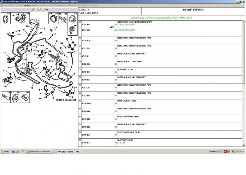

Looking at the pic from Service Box,
I reckon we're going to have to replace 'steering low pressure pipes' (9), (11) and 'hydrualic pipe', (10).
Anybody done any of this before? Any hints or traps for the unwary?
Nice.
