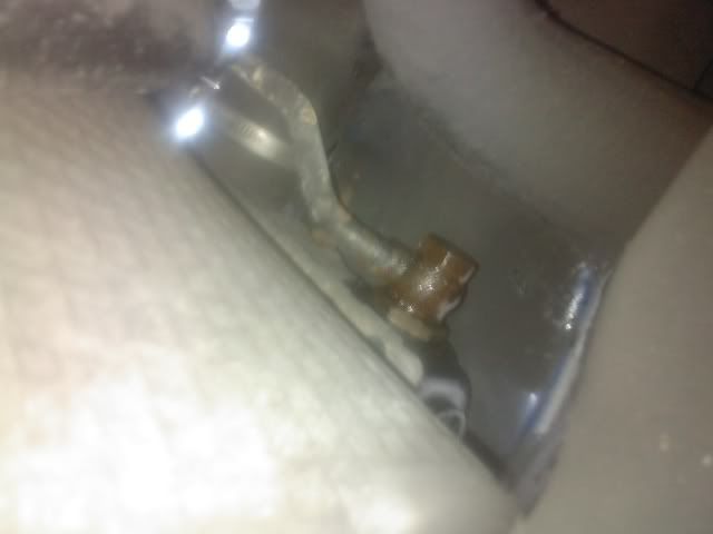

Right, almost got the rad disconnected. There's one more hose and a banjo union standing in my way.
When I tried to undo the banjo, it pissed oil all down my arm. What's that all about? I need to d/c it to remove the radiator but I don't want to lose, say, the auto fluid all down the road... anybody able to shed some light please?
It's located on the rear offside corner of the rad, almost half way up:
The man with no car
jasper5
Posts: 3689
Re: So what 'appened was...
Post by jasper5 »
If it is red oil, it's your transmission cooling pipes (as discussed above).
If it's engine oil, it's an oil cooler pipe.
Either way, you need to take out the banjo bolt, wrap a solid plastic bag round the pipe and tie it up so it doesn't leak....lift it up as high as possible too.
Screw the bolt back into the rad and catch as much oil as you can.....you could leave out the bolt and plug the hole in the rad with a small rag, a cork or rubber bung or something, either that or leave a drip tray of some sort under the rad to catch the oil.
When you have finished the pump job, fit the bolt back in with new copper washers.

Yeah, it's autobox fluid. The Omega forumites reckon it will 'dribble out' and not drain the box but you know, I think I'm gonna take Jasper's advice on this and bung it back up ASAP.
One guy also reckons you can de-pump it without removing the radiator. He's prolly right but with less than 1/2" space to undo the bolts and withdraw the shaft, I can't see that happening. Radiator's full of sh1te anyway, needs a scrub IMO :)

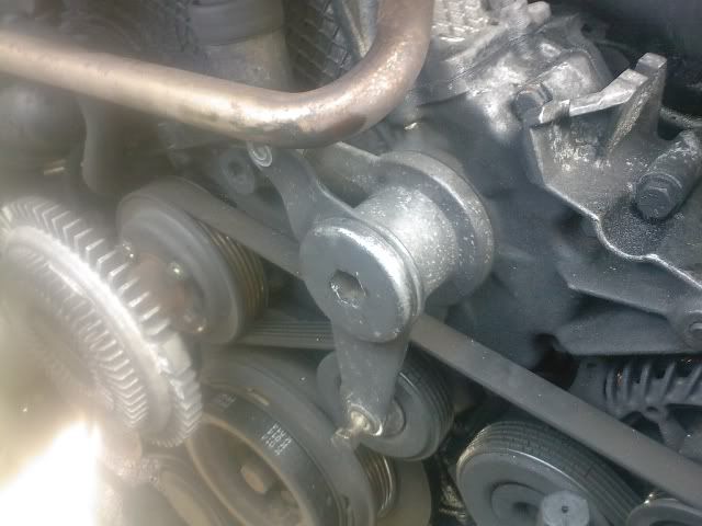

Radiator, viscous fan surround and the fan itself are off. Woo. No I have easy access to the viscous coupling and the rest of the auxy gear.
The radiator's absolutely filthy, fill of all sorts of crap. Tar, dust, grit, feathers, sweetie wrappers... gonna get a damn good clean before it goes back on, inside and out. Garden hose suitable for this?
Also, the auxy belt doesn't look too good. The inner, ribbed surface is networked with cracks. There isn't any adverse noise coming from the bay ATM, but I suppose you experienced peeps would advise a replace? We've had the car a year an a half and no idea when it was done before then.
Thanks for the continued support
Tom
[EDIT] OK, so pardon the ignorance but how does one untension this 'ere tensioner?
