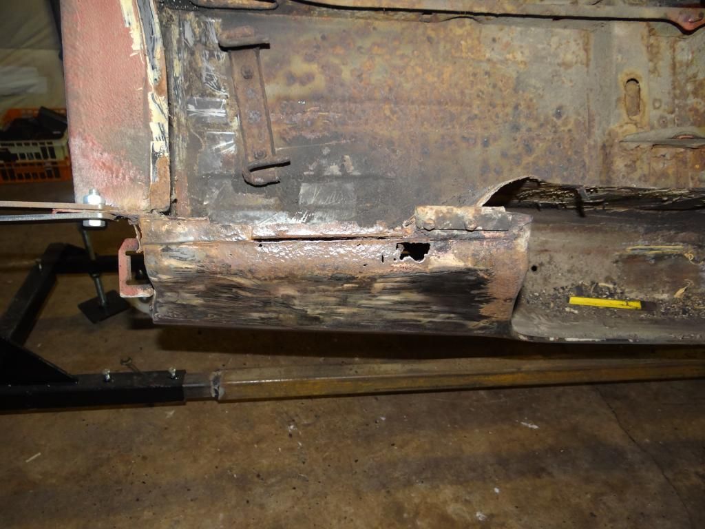

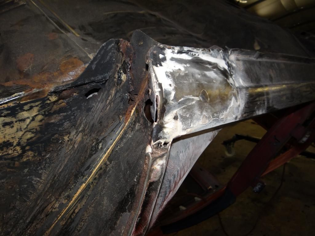

Some more pics of the 305 after a week of under seal scraping from the floor, its slow and monotonous, the gas torch speeds it up a bit but the only scraper that works is the cold chisel, a flathead screwdriver gets used sometimes for the awkward places, and I've started giving the areas done a brush with the wire wheel on the angle grinder, yes a few extra holes have been discovered but it will be easier to sandblast now:
the wheel arches are a bit of a nuisance with the gas torch, their shape means the flame whooshes back round to where your standing
tool of the trade

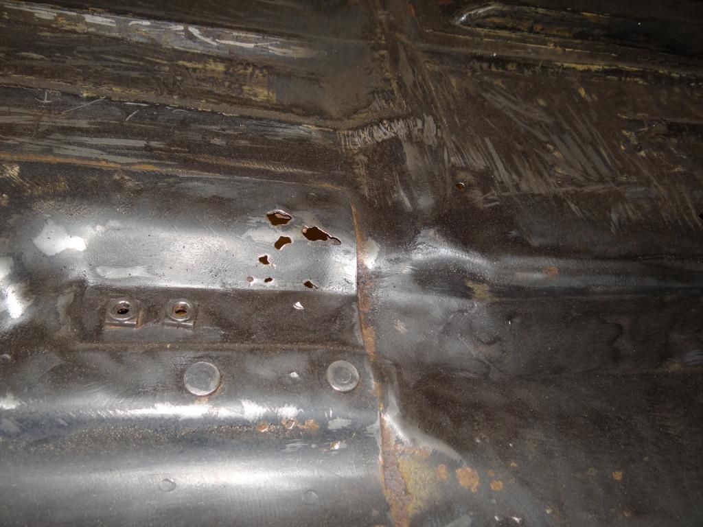

the bottom half has been done (passenger side if it was on the ground), new hole discovered Image

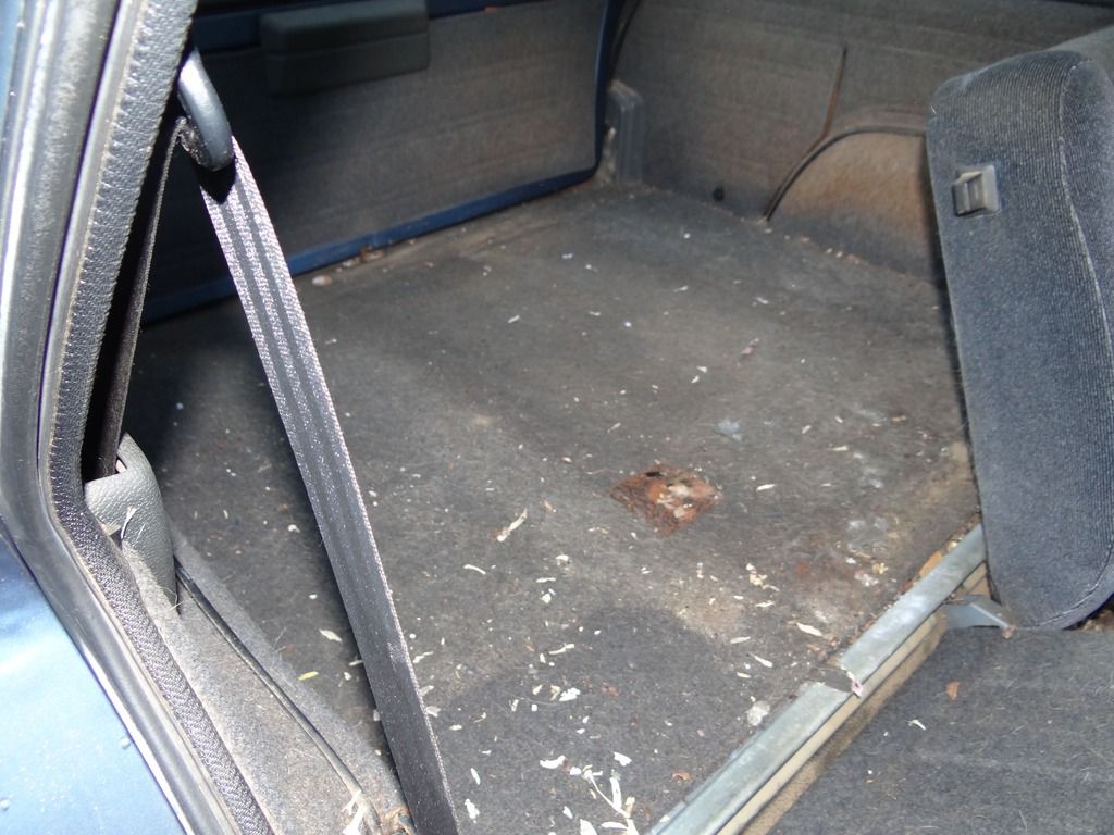

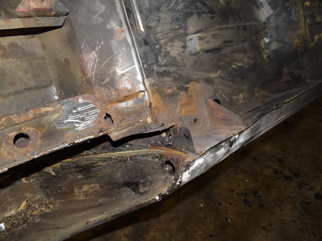

another new hole discovered on the drivers side, this would be under the rear seat:

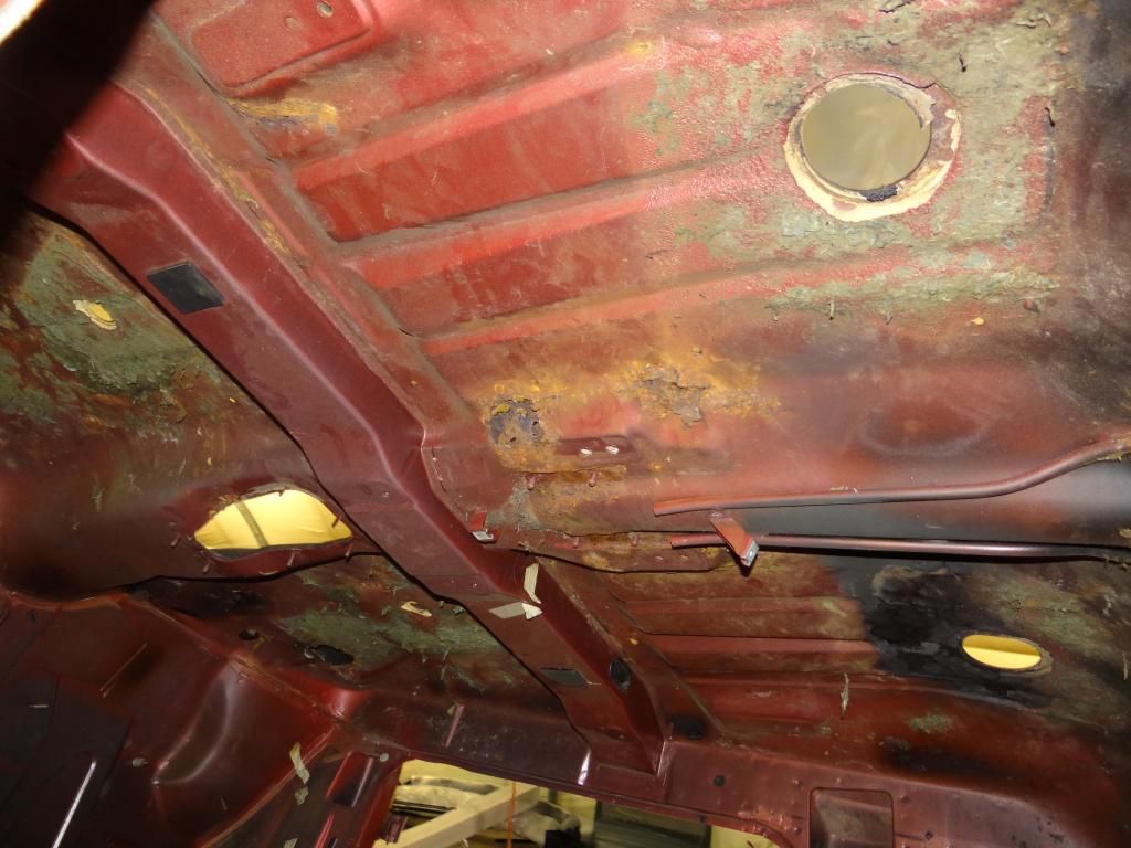

looking up into the car at the floor:

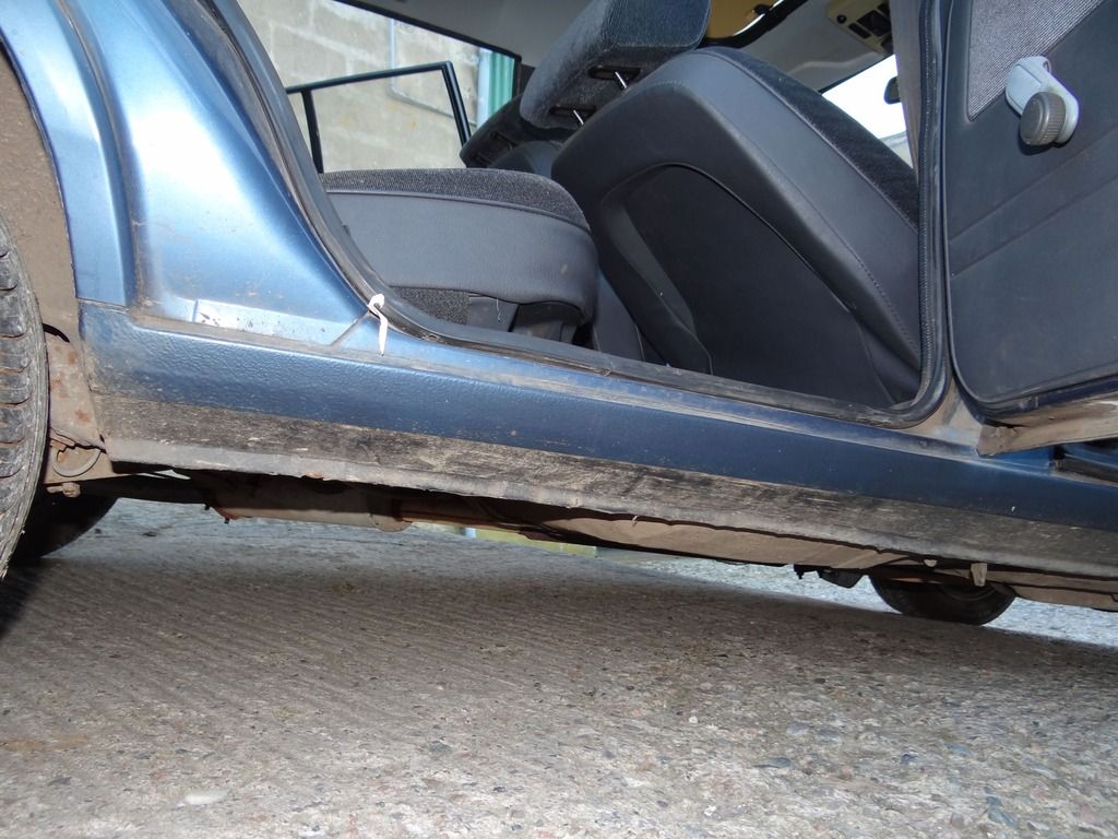

Passenger side sill, not to bad other than this patch at the back
Re: 1985 305
You're certainly putting the hours in there :shock: That's a surprising amount of rust in places you wouldn't really expect to see it, another couple of years and it'd be something out of Fred Flintstone...
Re: 1985 305
Plenty of hours spent on the car, about 2 every day of the week, then most of saturday. Hopefully another week will get the other side done, then the inside of the floor needs stripped.
I think at this age rust can be expected anywhere, but if the underseal got broken by a stone then its probably let the rust in.

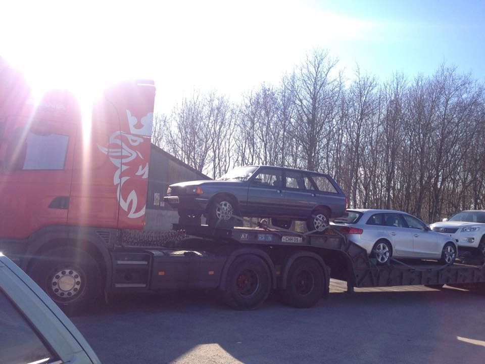

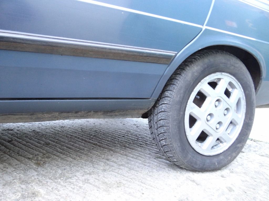

Another 305 delivered today, i bought the GTX, absolutley no need to do so but its a GTX :cheesy: , this is as near as the 305 would have got to an executive; luxury touches included velour seating, central locking, digital casette player, power steering, and the piece de resistance front electric windows, all standard today but these seem more special in a car like this, it arrived on the back of a lorry trailer, the man normally exports the machines we build at work down to southampton and brings back cars for people on the return journey:
Both the battery and the front tyres were flat, the battery doesnt last even after a jump start, but it drove around the yard for a few minuites:
there are spots of rust, finding a RHD 305 without some rust is almost impossibe, but amazingly both sills are solid and havent been patched up:

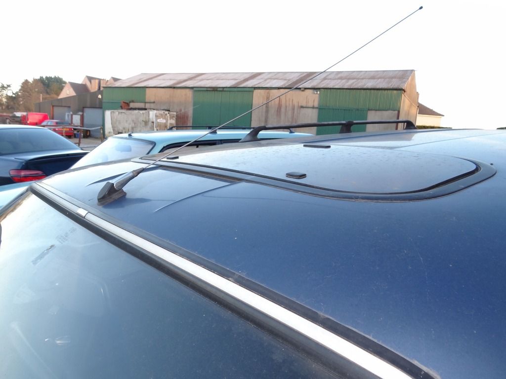

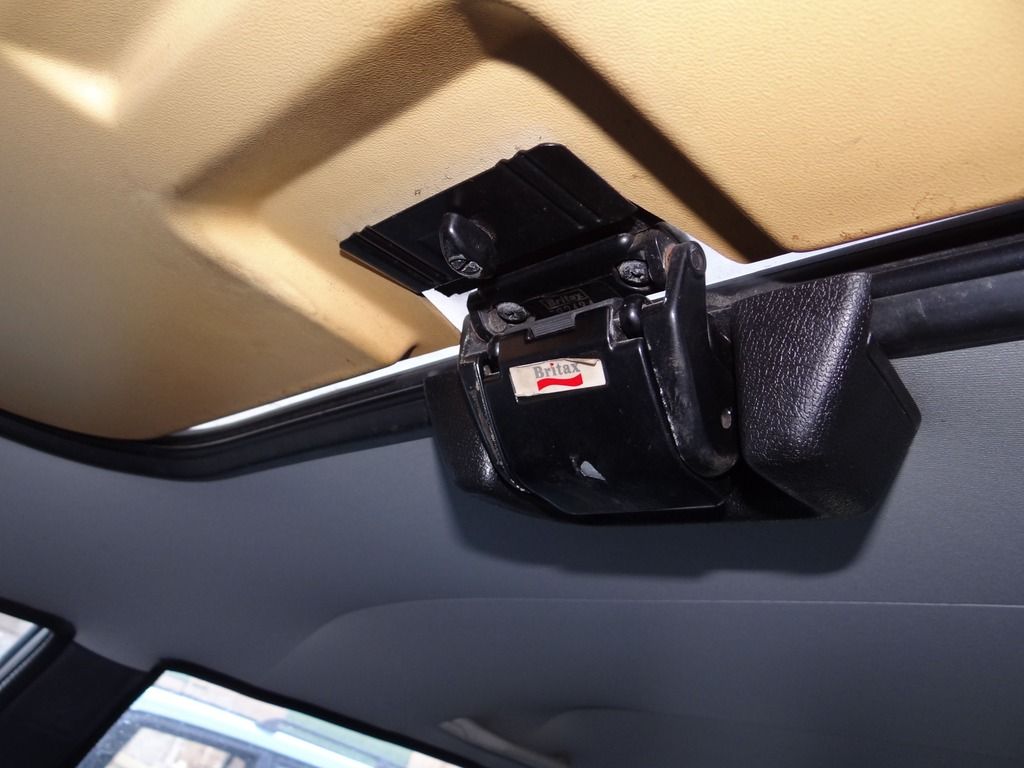

A sunroof again, but this one is a good quality britax one:

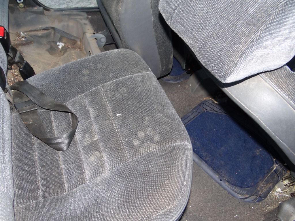

Velour luxury, and speakers for the dogs in the back:

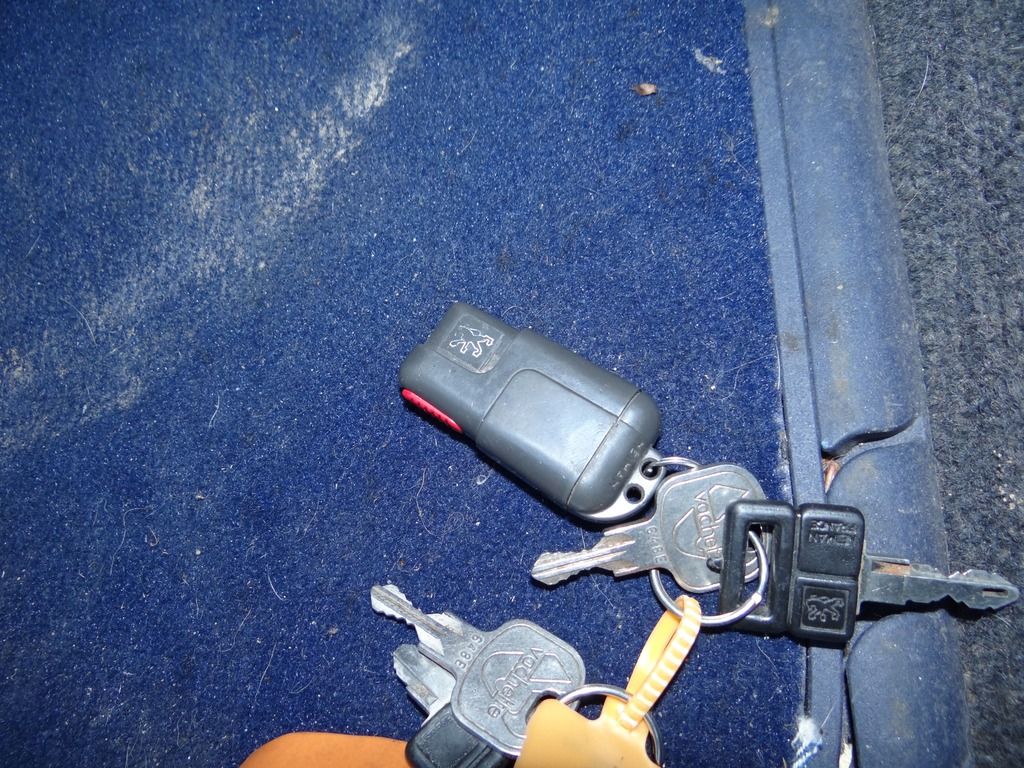

the central locking plip, looks a bit like a lighter:

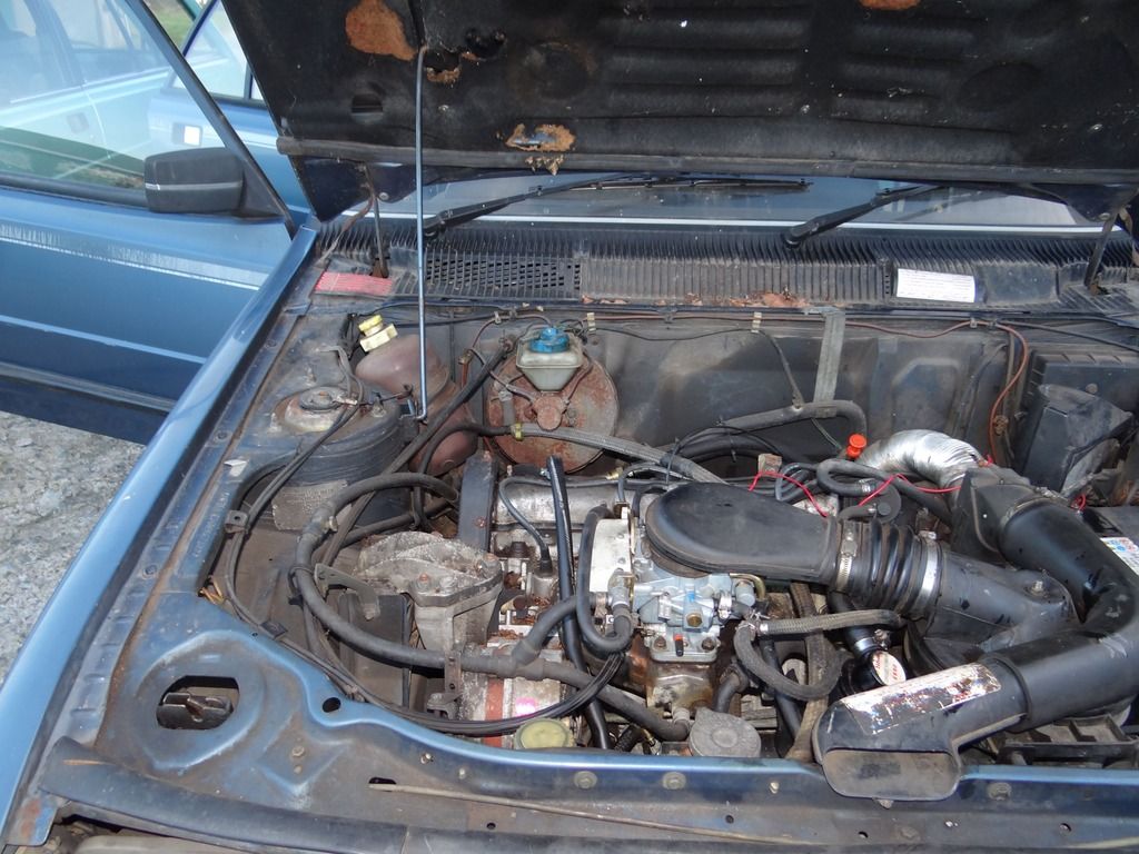

a 205 gti engine without fuel injection:

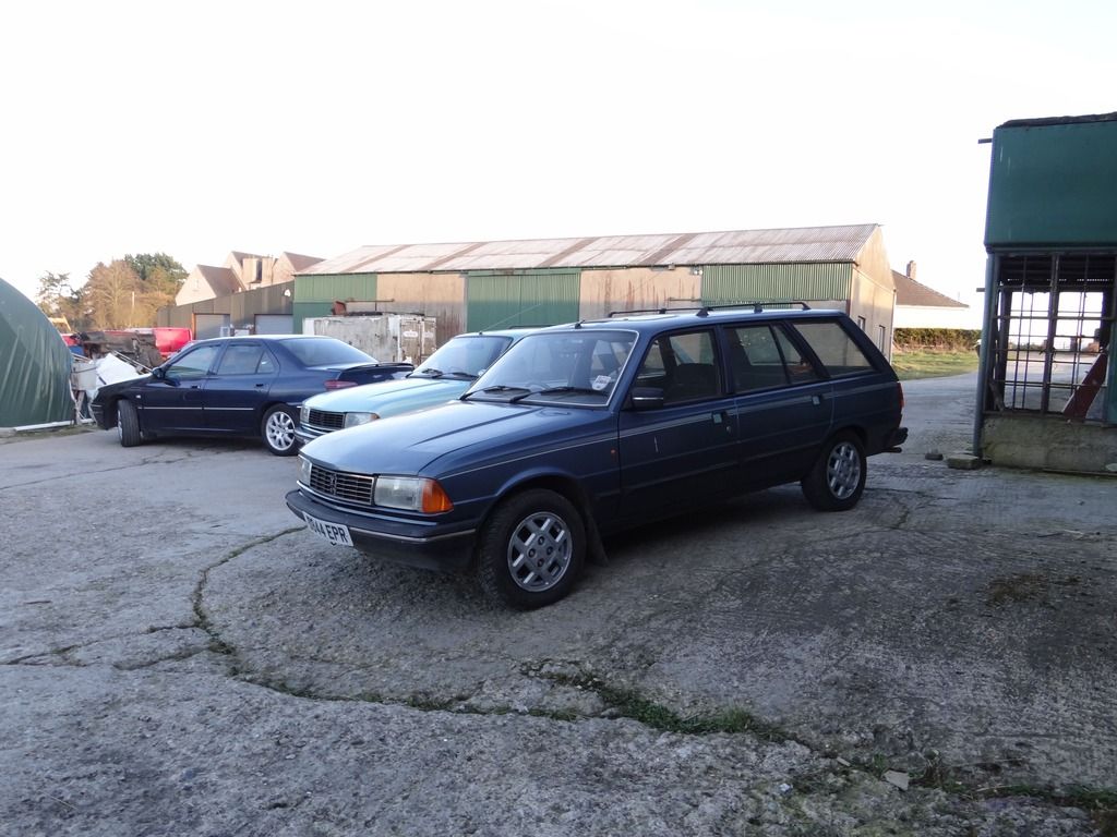

The pair, got the kickdown working on the automatic, the cable hadnt been connected to the carburetor i assumed that it was just a slow old car and to take it easy but its supriningly nippy, on kickdown it will drop down into a lower gear and rev up to 5,000 rpm before changing up.

Used to have a plip like that on our 505, only ours was held together by electrical tape and only worked once a month or so.

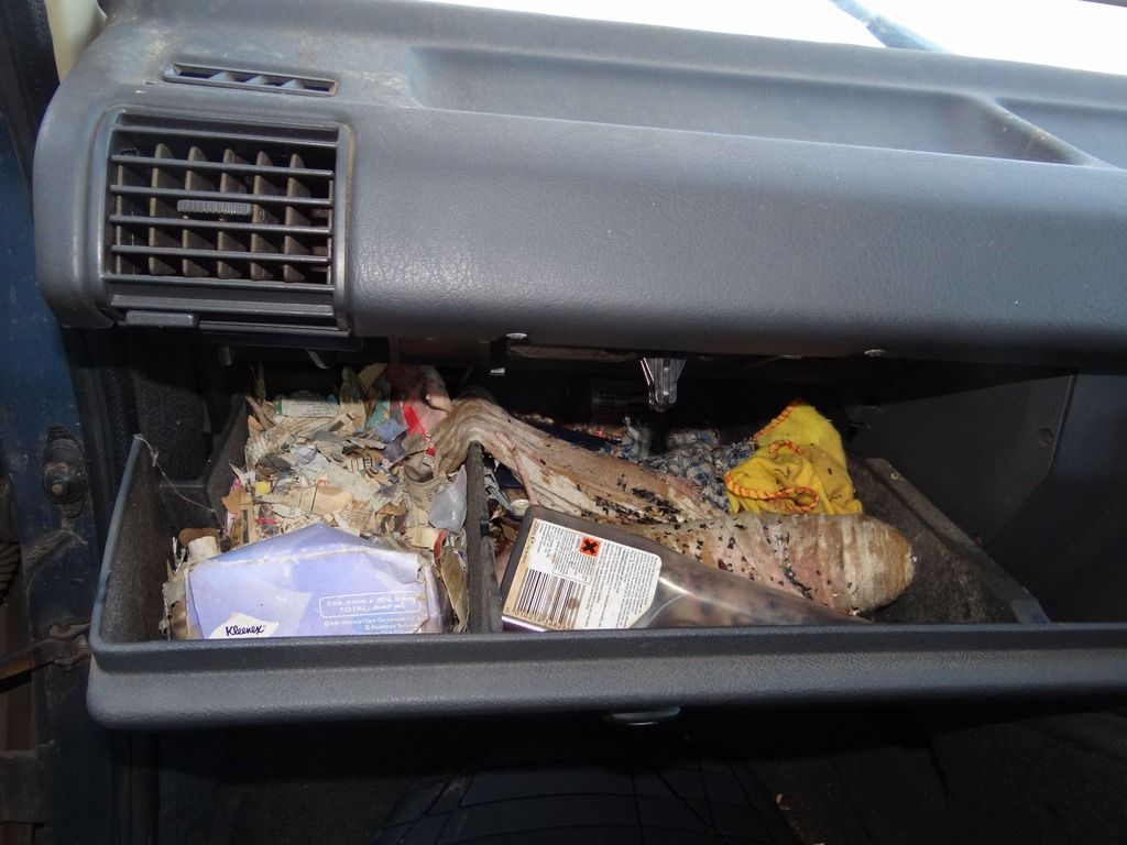

Odd looking contents in the glovebox:
