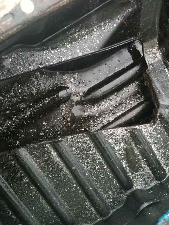

i tried getting the sump out but the last 2 bolts are a pain to get at, thanks to the shape of the mangled sump and the adaptor plate in the way.

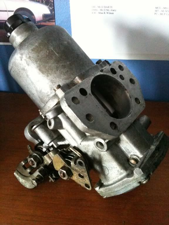

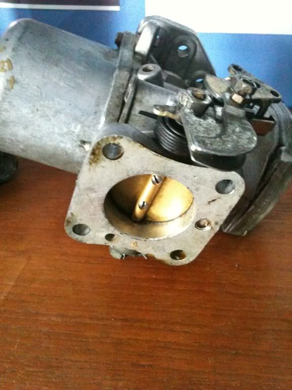

the carburettor arrived:
came nicely packaged, i opened it, there was a lovely smell of petrol, just what makes working on a petrol much better than a diesel.

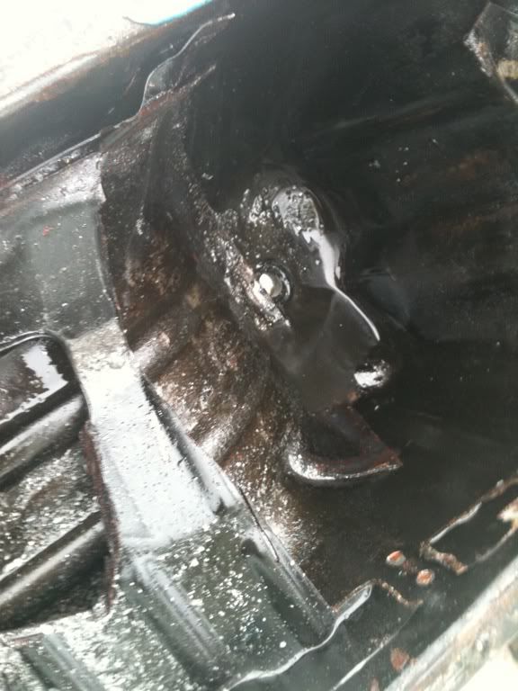

When you changed the sump did you alter the pickup pipe /strainer ?
Re: carburettor help
im having trouble getting the sump off due to access around the flywheel area and the adaptor plate, but it did go on, i was under the jeep yesterday undoing the other bolts, and whatever way i turned around i pulled my arm and my whole side is very sore, so i havent returned back under it today, but there isnt any point in doing it till i get another sump.

the strainer is in the oil but too close to the bottom im thinking.

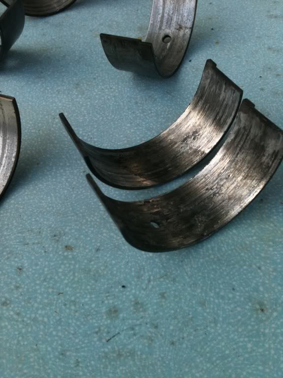

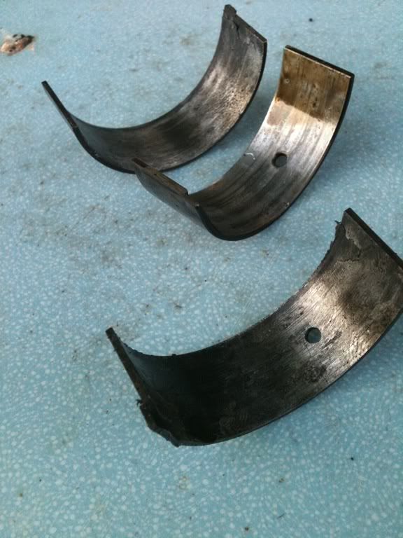

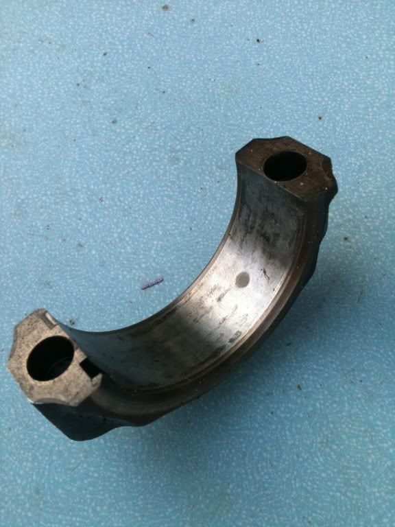

I went to the jeep today and got out the sump and pickup tube.
and:
the sh*t has hit the fan

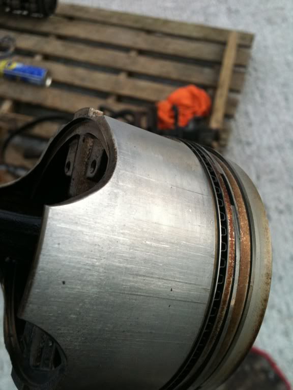

so i took the engine out, on the suzuki thats a very easy job took me just an hour, there was play at the big ends so i took them off, and the shims (is that what they are called) were in shite:
the crankshafts fecked aswell.
the moral of the story is, your engine needs oil.

Oh feck.
sorry to see its all gone pear shaped

Buggery sh1t
, thats not a good sign mate
scrap that engine and grab another Vitara, now the SJ fits the engine perfectly it will be a quick enough job and you might even make on the scrap value again
Ah well back to the drawing board eh

Shims? Thems is shell bearings
yup shells thems mate iagree,steve_earwig wrote:Shims? Thems is shell bearings
they dont like being dry for long
