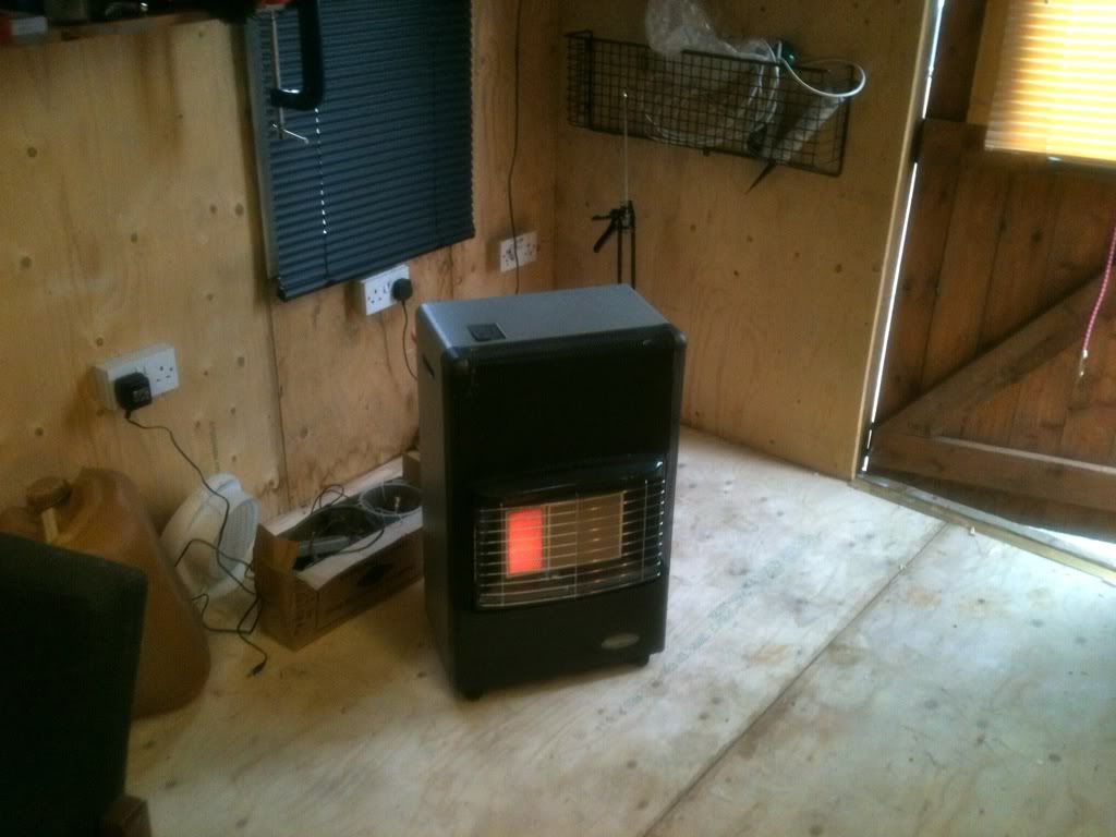

I got the Super Ser, put it into the shed and lit it up, it made a flame then a sound like a fart and spluttered off, the gas was empty.
£25 it cost for a fill of gas :shock: , the last time i got a tank it was £15. I wonder does car gas work in these.
Anyhow it heats the place up very well even on 1 bar, if there was insulation the shed would be too warm.
Re: Door Draught Excluder
Is that safe in a confined space?, you've already been a bit handy with the mastic gun so I'm assuming it's fairly air-tight in the shed. The products of combustion could be harmful to you if there's no ventilation.
To me there's only a couple of effective heaters for you and that would be a gas appliance with a balanced flue, or a gas appliance with flue + ventilation (not great as it will get cold in there) or an electric oil-filled heater.
it did heat up quickly but there wasnt a problem with the air i opened the windows to bring air in.

I thinks it's more about the appliance 'using up' the oxygen available and leaving you short. Being bottled gas it may be within the maximum allowance without ventilation (we don't need ventilation for a 4-ring cooker, I believe it's linked to KW output overall). Whatever fuel you burn will give off products of combustion like NO, CO, HC's etc in some measure.
thats a carbon monoxide alarm ordered, i about vents should i add a pair just to be sure, should they be mounted at floor or ceiling height, im thinking floor height being cold will have a better chance of drawing in air than something up in the warm air.
If it was me I'd have a vent at low level and high level on opposite sides of the 'room' to aid air-changes. The appliance will also give out some condensation, not much, but I wouldn't be that happy spending time sitting in a shed with that thing going full-chat.
*this advice is not "the law" you should get professional advice about gas safety, I have suggested you need ventilation but I am by no means a qualified gas engineer. Take it from me we'd all hate to learn of you being found slumped over a chair clutching a soldering iron and a wiring diagram for a 2003 BSi unit on a winter's night.....
Welly wrote:If it was me I'd have a vent at low level and high level on opposite sides of the 'room' to aid air-changes. The appliance will also give out some condensation, not much, but I wouldn't be that happy spending time sitting in a shed with that thing going full-chat.
thanks for the advice, but your right with this thing going full tilt sitting in the shed is unbearable.
some condensation did occur round the windows
