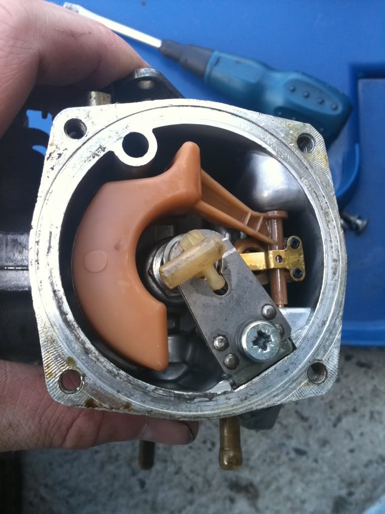

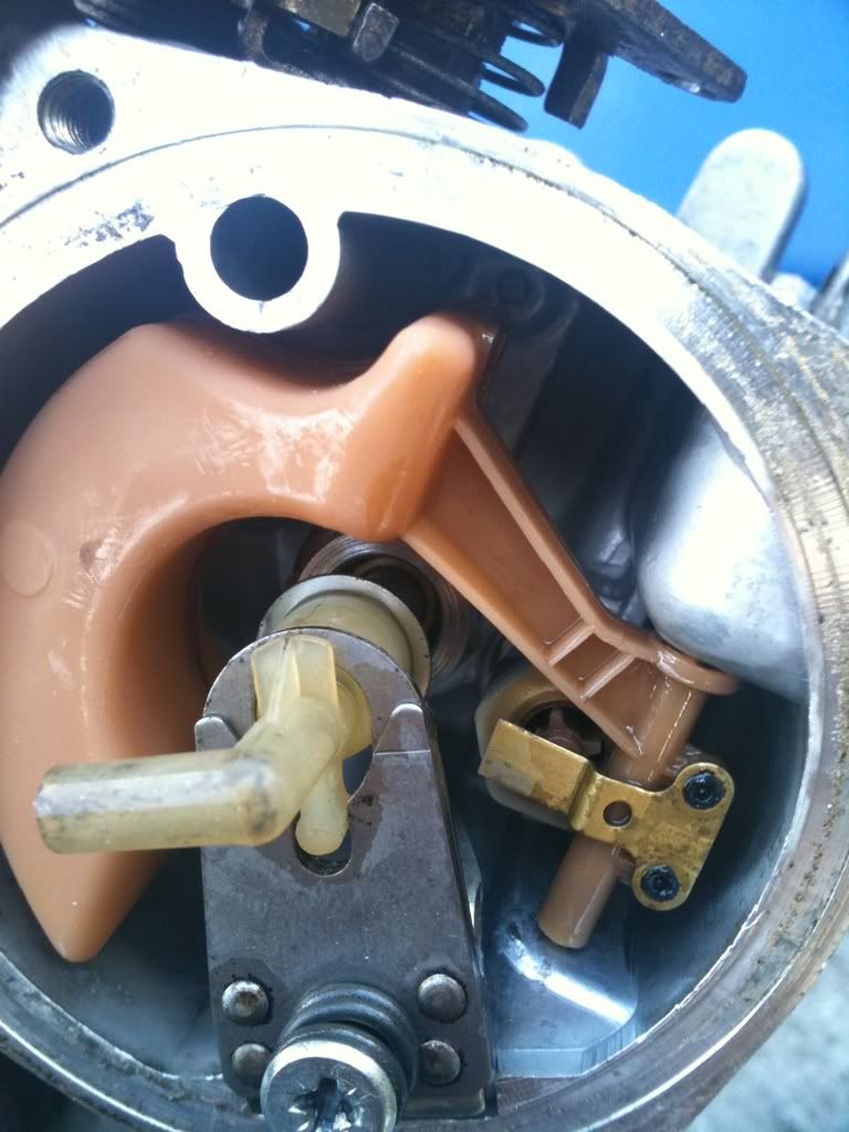

with the engine clapped out i had a look at the carburettor:
its a good thing, like new inside, all the seals are fresh.

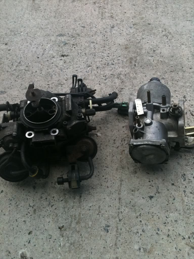

Its even better when compared to the old carburettor with all its over complicated emissions crap:

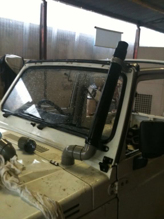

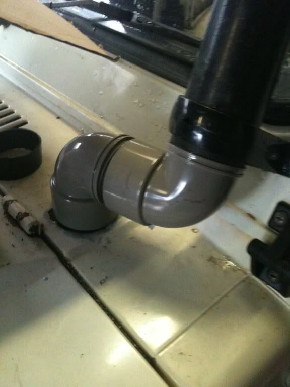

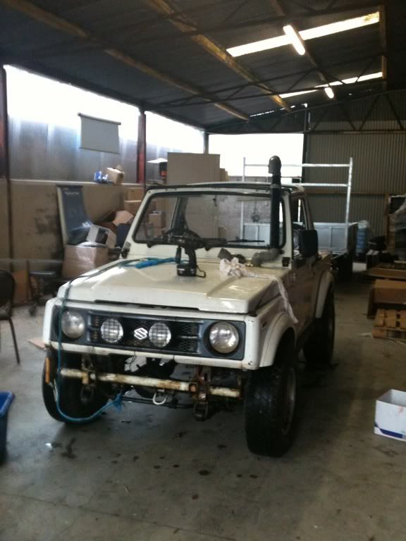

A bit of very crude engineering, i started to add the snorkel on the jeep, i havent finished as the drill is dead, and i had to cut the hole with a small drill bit doing many holes in a set circle as opposed to the easier and quicker hole cutting bit:
the end is facing down but i wont keep it like this, ill go and buy a proper snorkel top:
it will look better when caked in an inch of mud:

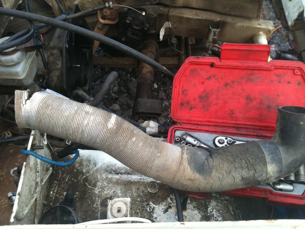

a question though, i need a bit of flexible air piping to do an ackward angle from the hard piping in the bulkhead to the air filer box, and then another bit from the box to the carb. Whats the cheapest stuff to use for this?

What about some of that tin tubing for extractor fans?

tin tubing, looks good but the jeep seems to have remains of that from the original setup:
its a bit brittle, but i suppose its heat proof.

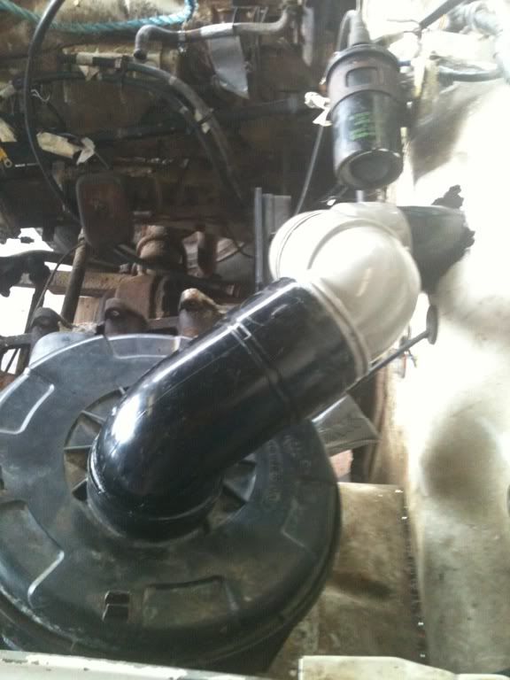

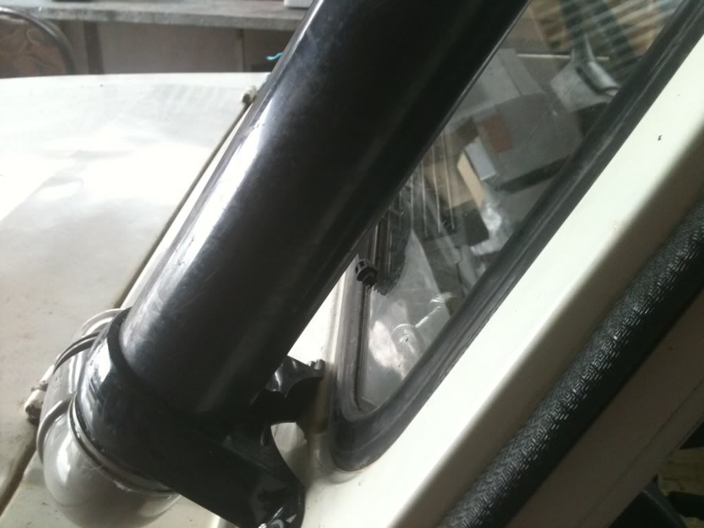

the snorkel doesnt go directly into the carb, in fact all ive done is sent the snorkel into the air filter box which has now been moved to the left wing where the wheel jack is supposed to be but its not needed as there is a forklift.
here is the air filer box:

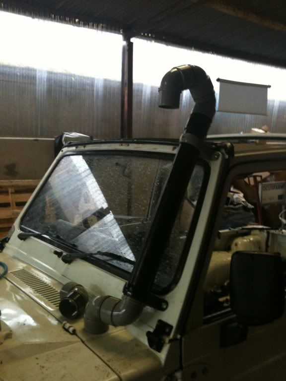

the snorkel is now finished and in typical home made style its not perfect, it robs some passenger foot space:

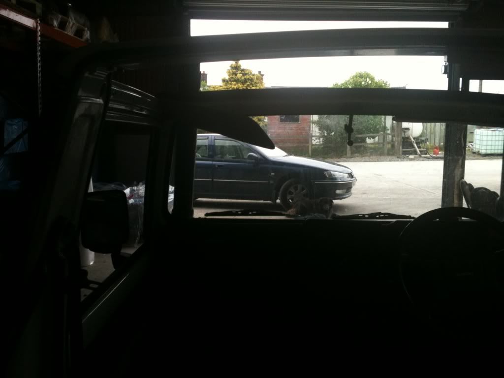

but its not too bad on visibility:
the wiper can still get past:
guess where this came off:
but i dont think i need any special thing apart from a normal snorkel top, the air filter can do the rest of the work.

Ah i see now, i thought you were going straight to the carb with the flexi you were looking at, as you are not then it will be fine with just the bends on it the snorkel top is purely optional .

a bit of pasteurs swan neck in the snorkel
shouldnt do it much harm? ill need the mushroom top or else water would sit in here for ages.

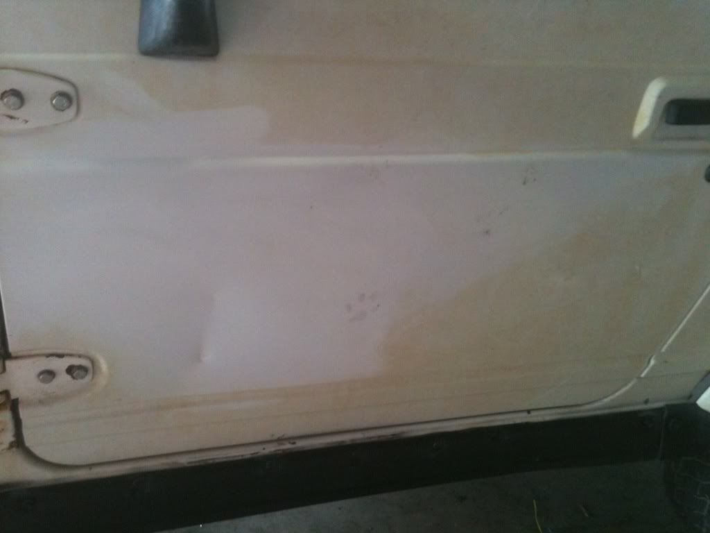

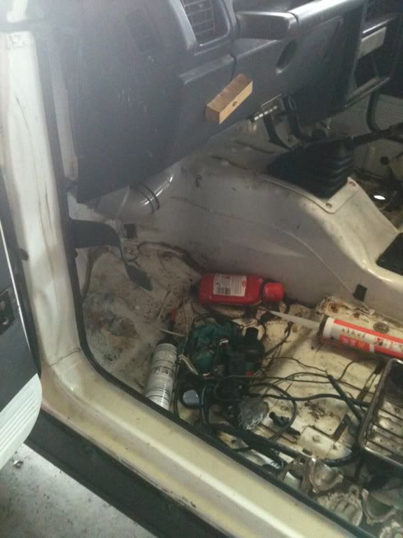

the t cut, that was an attempt to give it a clean:

Are they paw prints? On the side? How did you get paw prints on the side?.....
