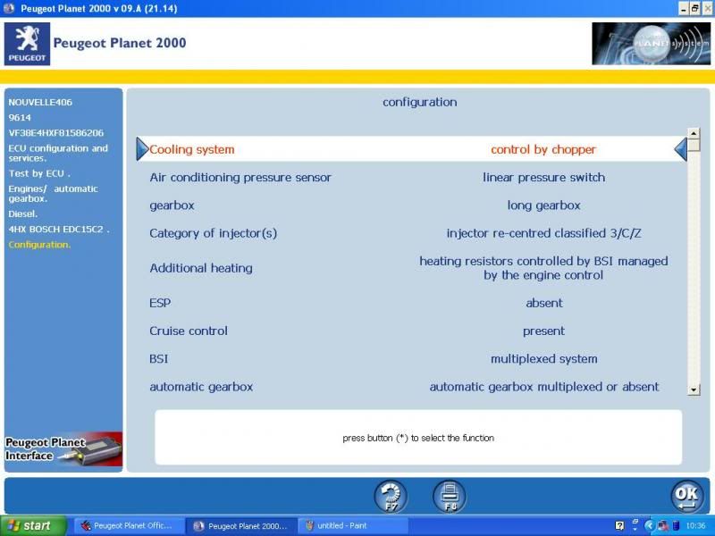

Hello again reader :cheesy: I've been having another look about to see if I can find anything useful on the ecu connectors (in between everything else I'm meant to be doing...) and it's occurred to me that I really ought to check that the ecu has the ability to run cruise (I'd look a right berk if I did all this and it didn't). So, out comes the PP2k for the first time evvarrr :oops: Plug it in and... what is all this? I have no idea what I'm doing. I've read that I need to enable it in the ecu and the BSI but all I've come across is this:
Does that look familiar to anyone? 'cos it's different to everything I've seen. If I double click the cruise I can set it to present. Double click it again and I can set it to missing :shock: Abort, abort, abort!!!
Erm, am I doing it right? :oops: :oops:

I've never turned one on, but I think it works like this:
Function needs to be turned on, (present), in engine ecu and BSI - without the latter I think it will not 'see' the stalk/switches.
You should be able to verify operation of all the stalk functions and both brake switches on PP2000, though they seem to be spread over several pages and inconsistently from car to car - try driving parameters and BSI diagnostics........

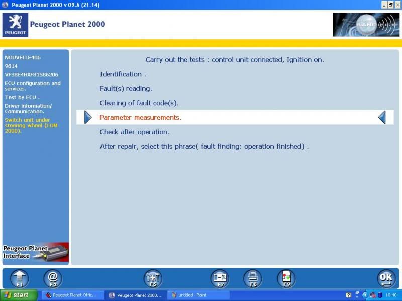

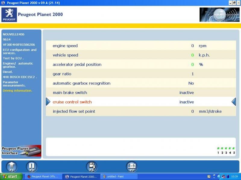

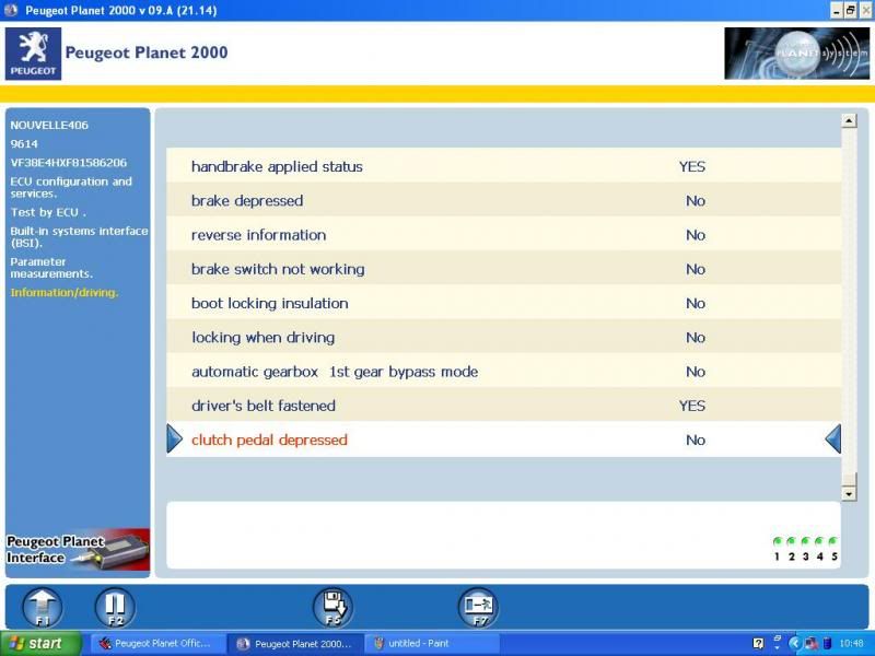

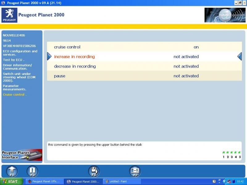

In no special order, maybe these will help?
Engine ECU cruze option selected.
BSI cruze option selected.
BSI checking clutch switch
Com2000 parameter measurements....
CC controls
Engine ECU, brake switches

Doggy wrote:Image
Must take a certain degree of talent to be able to control the cooling system using your chopper... :supafrisk:
Re: and today i have mostly been...
Hur hur hur. I guess it means the fan but... it's a bit of a daft name. It's probably another bum translation from the French (remember particular light?)

I've sussed it and I am a complete tit - notice how Eric's says "NOUVELLE 406" and mine don't? :oops: :oops: :oops: :oops: :oops:
Anyway, yes I can enable cruise in both the BSI and the engine ECU 8)
