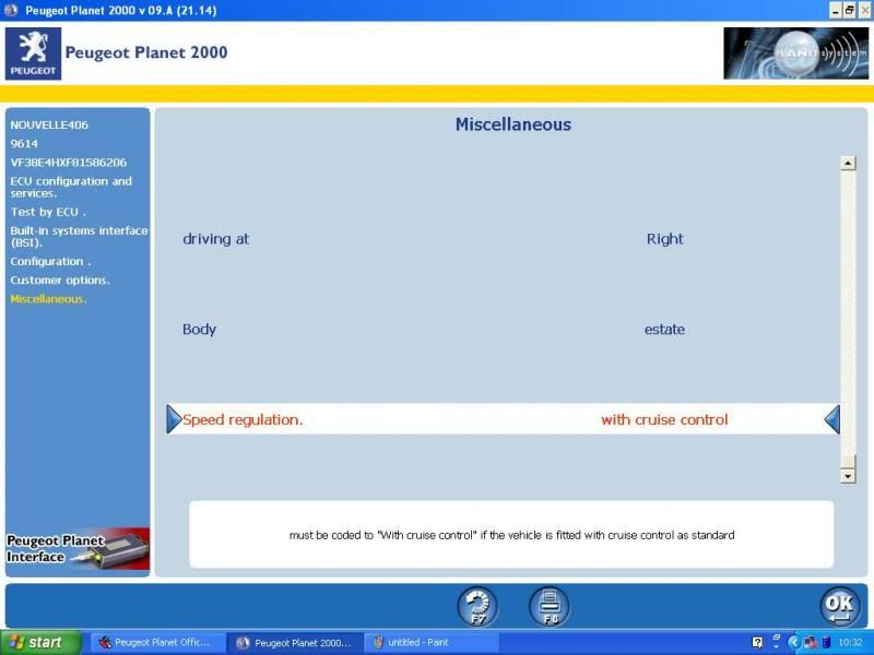

steve , what year is you car ? ,i'm trying to fit cruise control to my 2003 hdi i have the cruise switch fitted and enabled in the engine ecu i could see any option in the bsi to enable it, i get a brake fault code when i try and use it as there doesn't seem to be a brake switch just a connector hanging there which is for the brake switch i think, does you car not have this ? :)

davew wrote:steve , what year is you car ?
December 2003 build. That's the wiring for the redundant brake switch, that's what mine was missing and I've had to run a wire in for it.
davew wrote:i have the cruise switch fitted and enabled in the engine ecu i could see any option in the bsi to enable it
Is there a "not" missing from there somewhere?
If you're not finding the option in the BSI, did you follow the navigation here?:
:arrowd:

strange that mine has the wiring and yours doesn't , i will check again with PP2000 i think i missed that part when i looked at the bsi :)

...playing the PP2000 Hokey-Cokey :roll: (you turn the ignition on, ignition off, on, off, on, off, then economy mode shakes you all about :x )
I tried pulling the brake light switch one notch up again to no avail, so I went off searching Doggy's words of wisdom for what he meant about setting the coherence up using PP. I soon came across this pic:
in this thread viewtopic.php?f=3&t=15798&p=155165&hili ... pg#p155165 So I plugged the dreaded PP back in but the cruise control switch refuses to say anything other than active :( I've checked the connector again and clocked from the redundant brake switch connector to the plug on the ecu, so either I didn't put the pin far enough in (I was using a pin pushed in the bottom to test it and it's right down there) or SEDRE is talking ballcocks and it's the wrong pin. Damn :(
While I was in there I set the clutch switch information thingy back to absent. I also checked the BSI for faults:
Interesting... I've cleared them anyway, let's see if that one comes back again.
I also noticed that the sill lights had mysteriously been set back to absent again :frown: Unlike last time they were permanently off. Why does it do that? So I set it back to present, hit the Configuration key, and the program locked up - ARGH!!! NOOOOOOOOO!! Wtf do I do now?? Worrying that just unplugging it would scrap all the settings and possibly the BSI, I rebooted the laptop. It was at this point I realised the car had gone into economy mode :roll: That's a clever bit of design right there. I got that sorted, then I noticed that the multiplexed brightness/rain twin sensor had set itself to present - I knew it had been absent before because I'd been wondering what a twin sensor was about.
I wonder what else has been reconfigured without me knowing :(
