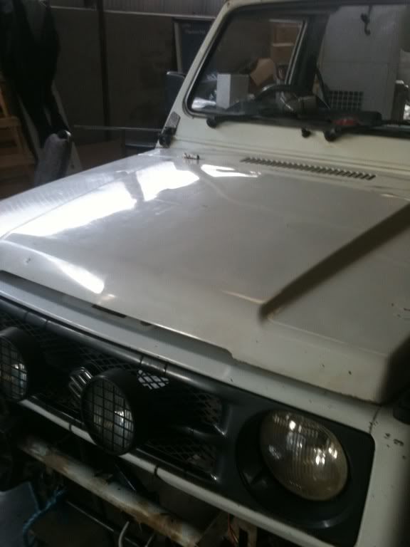

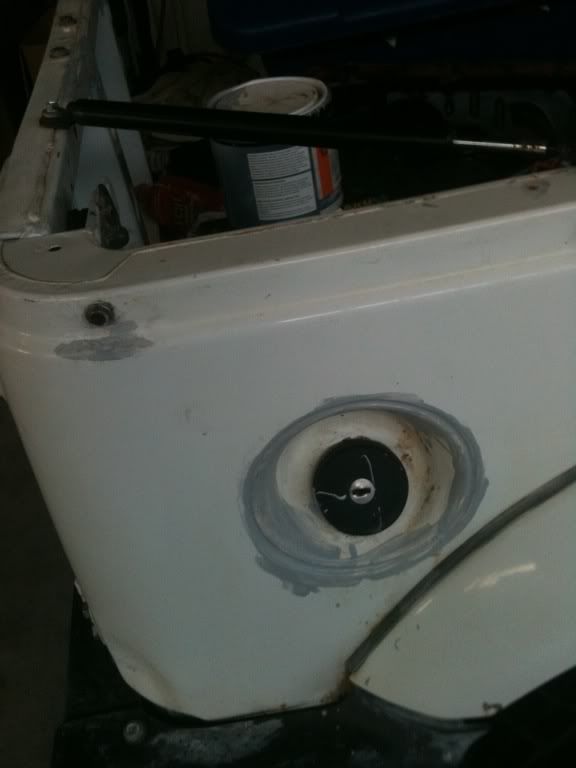

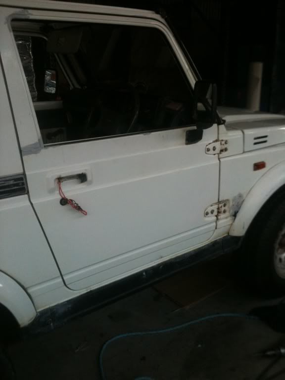

the muck after a while leaves the yellow colour, it comes off easy engough with the tcut but i never finished it.
as for the paw prints i dont know how they got there, its too small for my dog, i think the bagel hound may have jumped up and did that, shows it didnt care about the paintwork.
Re: carburettor help

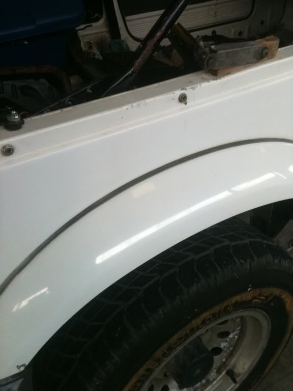

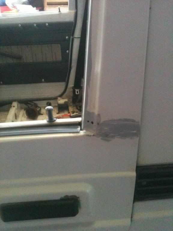

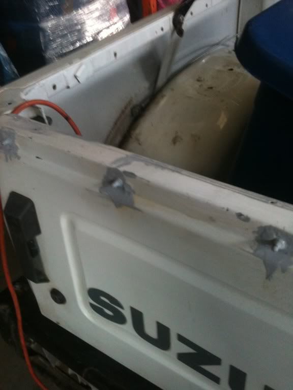

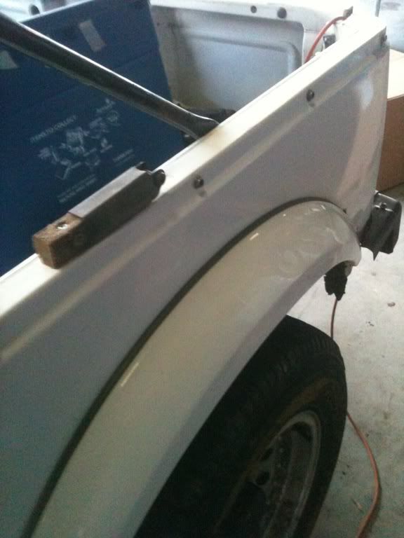

i finished using that bottle of t cut:
i went round the rust spots and dabbed a good amount of galvanising paint on them:
it says it stops rust getting worse and at the moment thats all i need, leave the bodywork for another day without the jeep crumbing away.

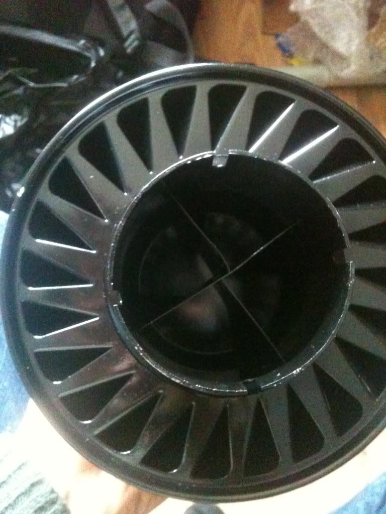

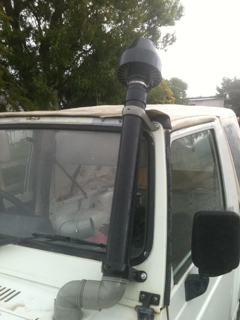

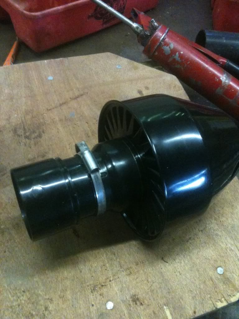

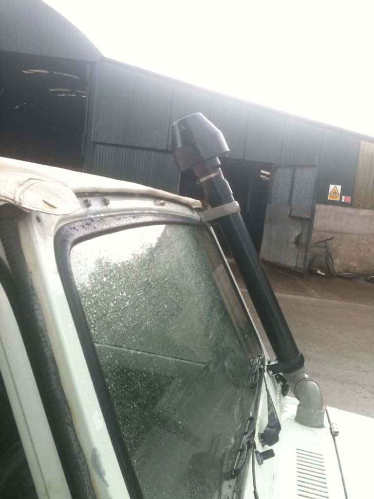

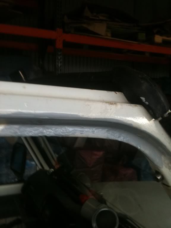

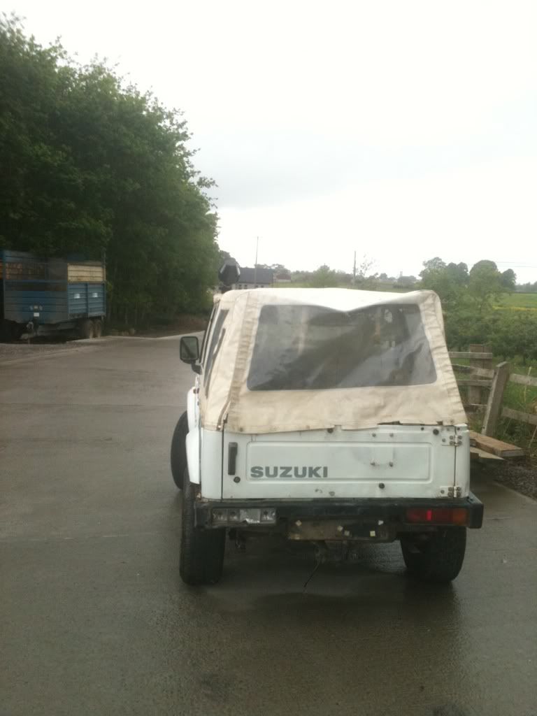

the mushroom top came:
with a bit of brute force it was put onto a pipe end:
and then it just plonks onto the jeep:
(the roof has that unique shape because i tried using a ratchet strap to pull the bar down but the bar just snapped in the middle giving that v shape)
if its ever going to wade through water that deep ill need a snorkel for my own air intake.

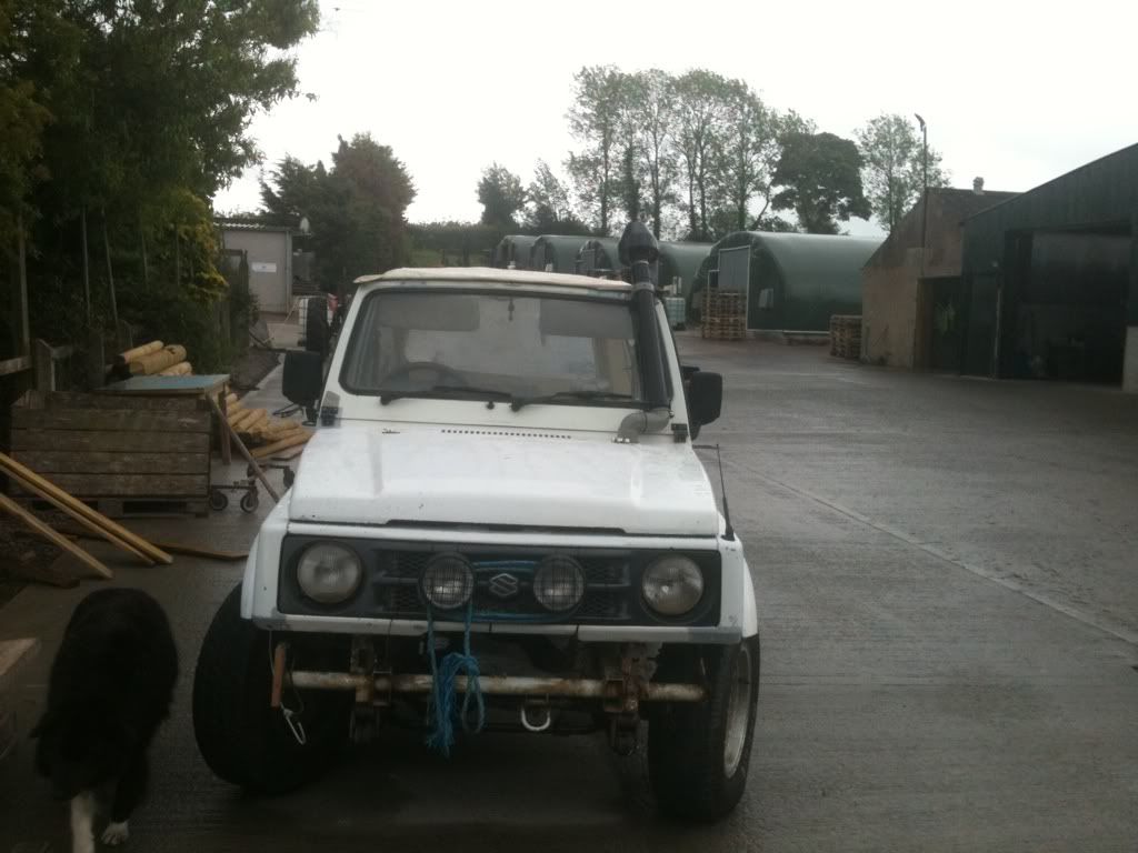

Looks good that mate,
Whats them Green pop up sheds in the Background on them pics ?
iwouidnt mind one of thems where couid i buy one from, are they canvas on pole frames or are they all metal construction on the inside ?
Itake it you grow Shrooms in them ?
