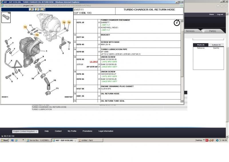

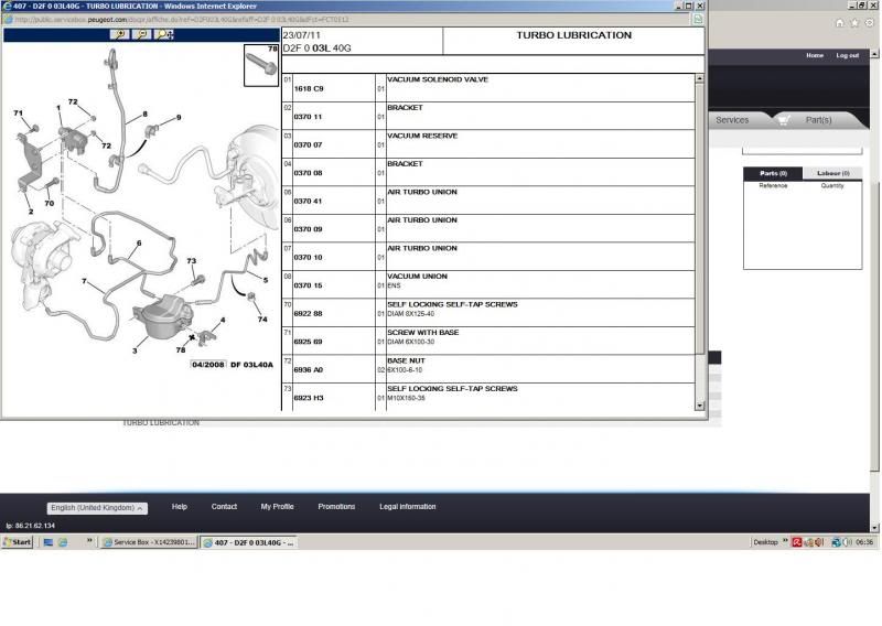

I was trying to pin down the filter / gauze in the turbo lubrication, (friend has a 307 1.6 HDi), ServiceBox seems spectacularly misleading on this occasion:
Could it be thre first vacuum lubricated turbo? :?
Thought I'd try the 'Oil return hose' instead:
The link in red doesn't work either, BTW. :?
